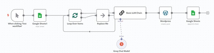

How can I create an automation that reads some titles from a Google Sheets file, sends that title to an AI and then publishes it in WordPress?
I have almost everything done, but I can’t get it to read just one title, it takes them all at once and publishes them all at once.
I have done this:
Any ideas?
We’ve created a new category for help with designing workflows, and I’ve moved your question there: Help me Build my Workflow. Find out how this category works by reading this topic.
I use the web version, not the one installed locally.
If you just want one row from your Google Sheet you could put a ‘limit’ node after the node where you read from your sheet.
You don’t actually need the loop since n8n nodes run once for each item, but if you want to keep it (for more control) you need to move the agent and Wordpress nodes inside the loop (replace the ‘replace me’ node with them). Right now the loop isn’t doing anything since there’s nothing inside it.
