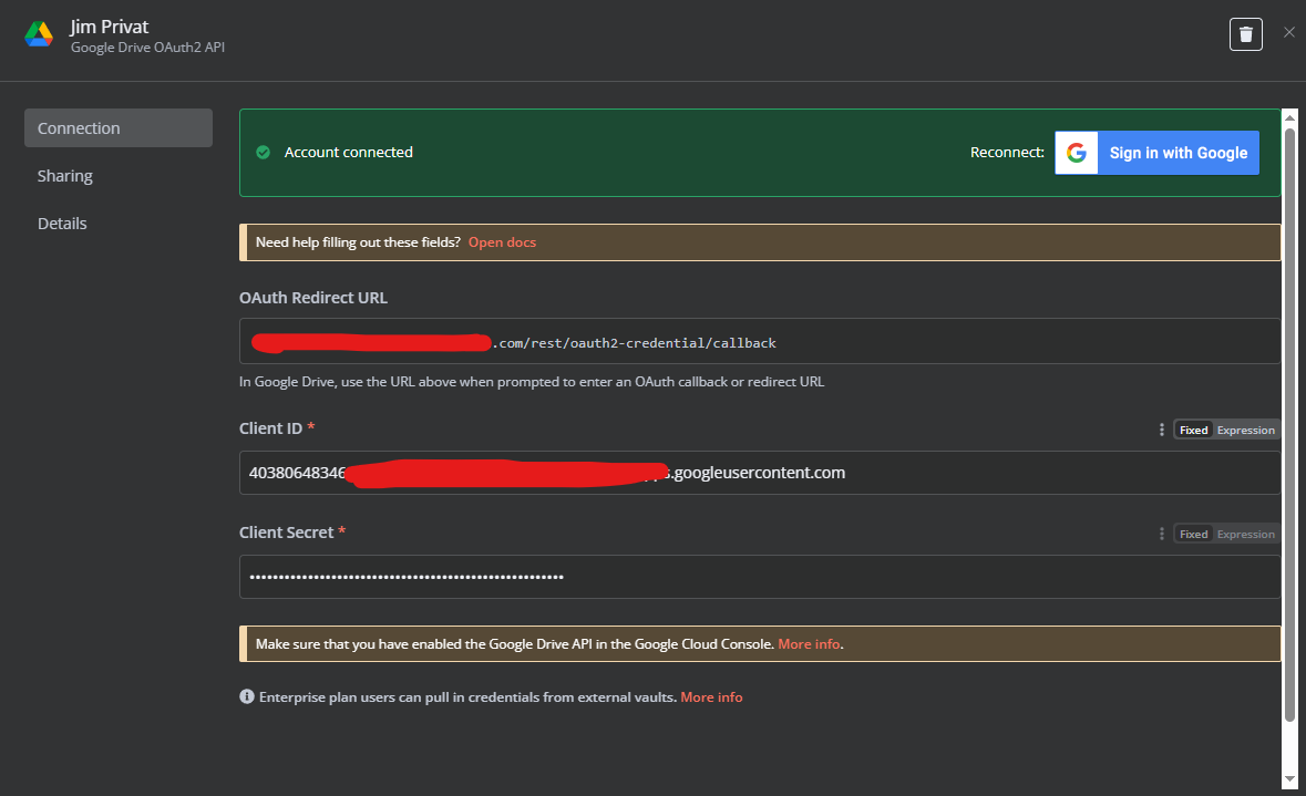

Google Drive, Gmail and many other Google Products keep disconnecting in my n8n instance. Clicking on “Sign in with Credentials” reconnects immediately, but it only stays connected for a couple of days before requiring me to reestablish the connection again.
I’m hosting n8n on a GCP instance but didn’t have these connection problems before. The OAuth tokens seem to be expiring frequently, requiring manual reconnection every few days.

Could you also show your cred setup (blurring/removing half of keys/PIIs)?
Thanks for the response. I am on version 1.81.4
