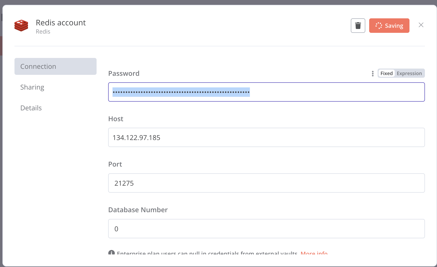

Rediss connection
cant connect to Redic from n8n credentials settings
keep spinning
I tried to put USER:PASSWD to “Password” field - no luck
I can connect using CLI
redis-cli -u ‘rediss://USER:[email protected]:21275’

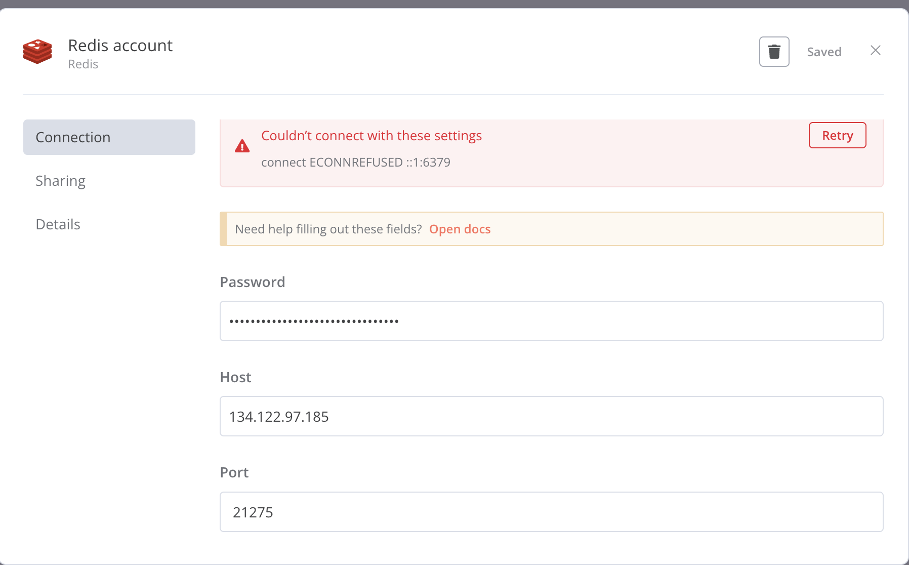

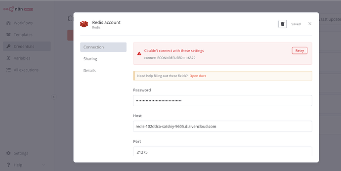

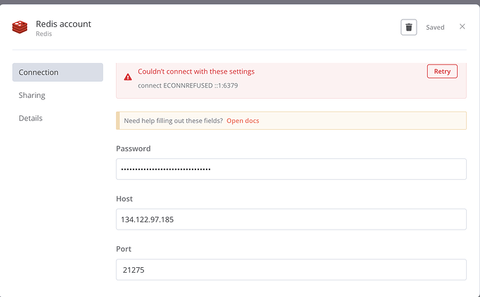

I tried putting default:PASS into Password field
for some reason, it is trying to connect. to. 6379. port according to screendhot
yes im accessing Redis from same local network
The error ECONNREFUSED ::1:6379 implies that not only is the port incorrect, but also the host (::1 is localhost in IPv6).
Unfortunately I’m not able to reproduce this issue.
Can you please try creating a new Redis credential, and see if you can still reproduce this? :pray:
BTW, for SSL to work, you also need to use the hostname of the Redis instance to make sure that the hostname matches the domain in the TLS certificate. using just the IP will likely return a TLS error.

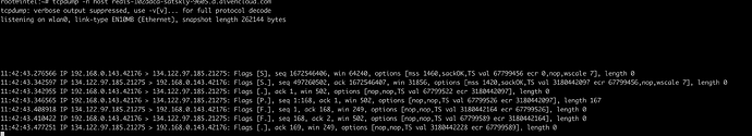

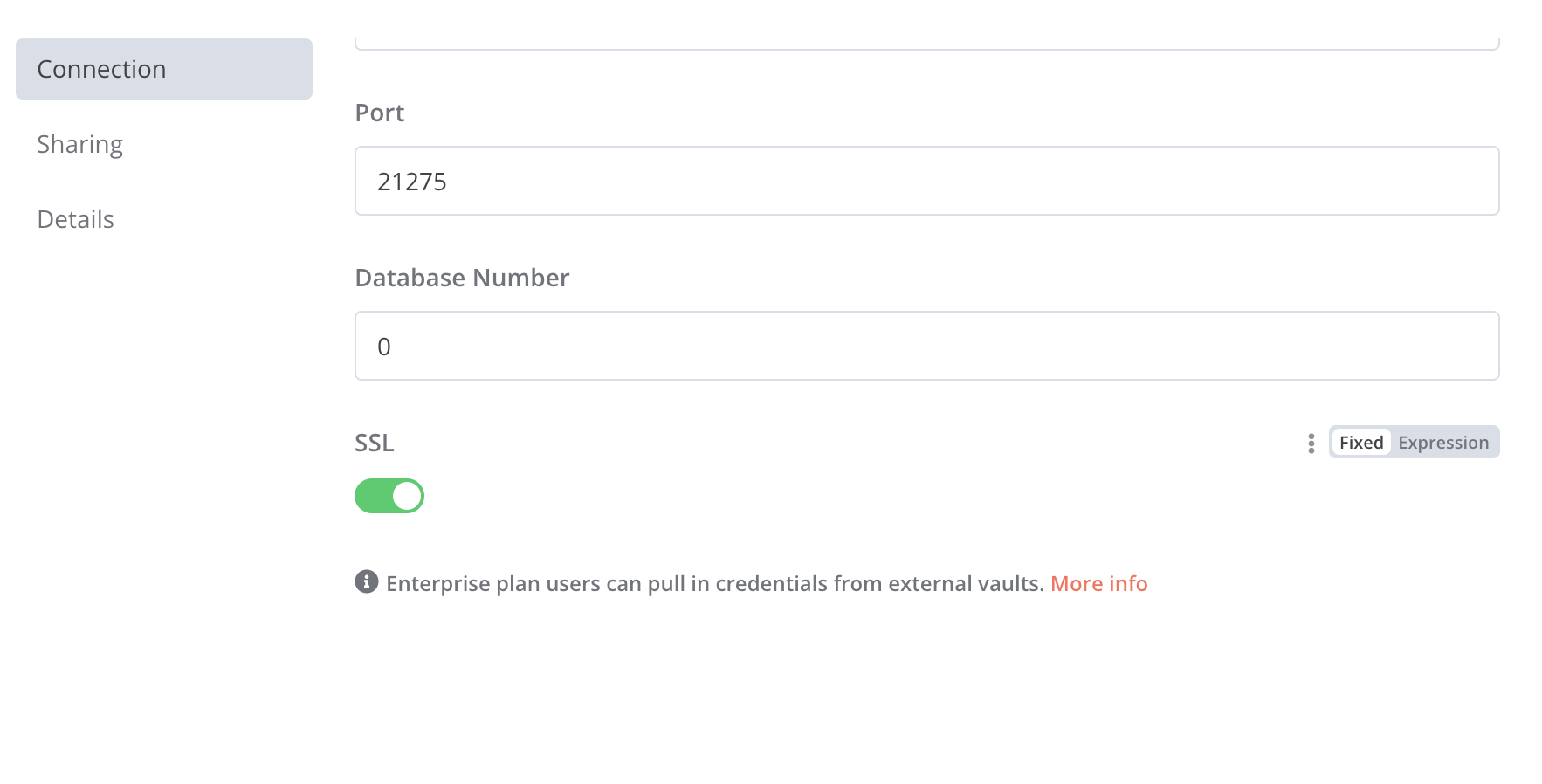

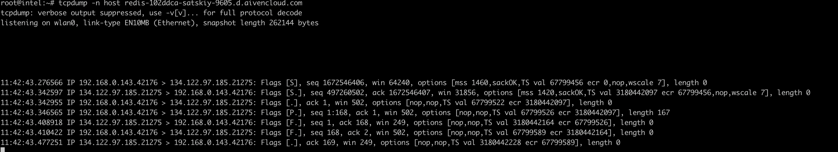

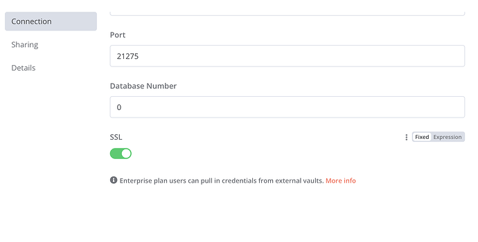

Checked TCPDUMP and noticed when i did not set SSL on Redis Cred config
there is a traffic to 21275 port
but when I switch SSL tougle → NO traffic in tcpdump
So node is not sending traffic at all
P.S.S
I tested and I can see traffic in tcpdump
when I’m using redis-cli with rediss://
Sorry, this was due to a stupid mistake on my part.
When SSL was enabled, the code I changed was overwriting the host and port values being passed into the redis client options.
I’ve updated the PR, and also create a new docker image with the same tag.
Can you please pull the docker image, and try again :pray: ?

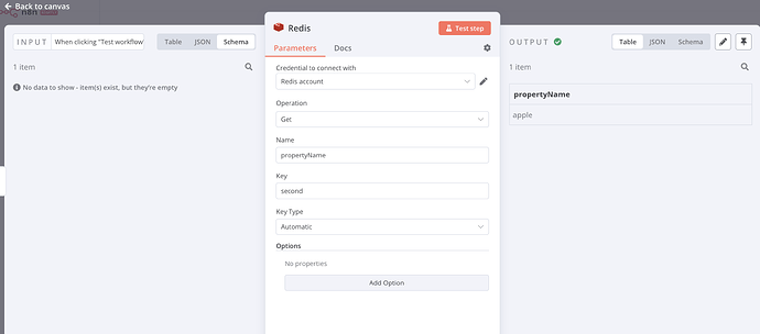

it is working now!!!
thanks
when this nightly update will be in the latest ?
FYI
I just had to put password (without login) in a password field
