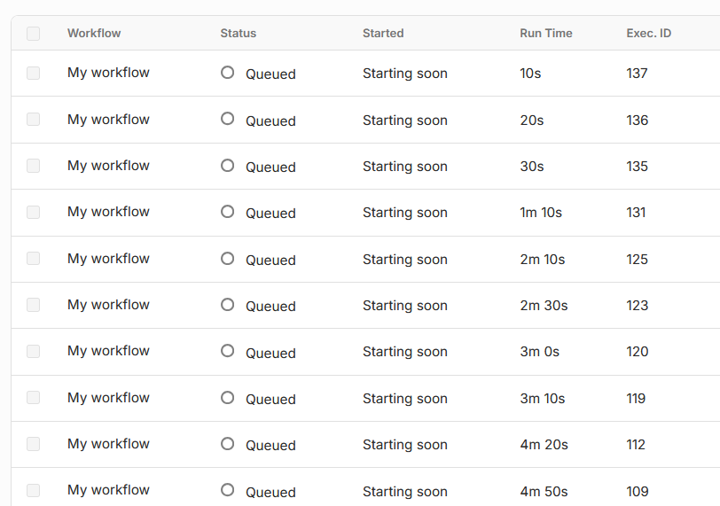

Hi,
I would like my N8N not to execute workflows when another one is in the queue. To do this, I use regular execution mode with the argument: N8N_CONCURRENCY_PRODUCTION_LIMIT. When I launch a workflow with a schedule of 10 seconds and a wait time of 2 seconds, this happens:

Hi, @Necroun !
N8N_CONCURRENCY_PRODUCTION_LIMIT does not control when a workflow is triggered. It does not stop the trigger from firing and it does not cancel new executions. It only limits how many executions can run at the same time. Because of this, scheduled triggers will continue to create new executions, which are queued internally and start as soon as the running execution finishes. This is expected behavior.
If you need strict “one-at-a-time” behavior (no queued executions), you must implement a logical lock inside the workflow (for example using Redis, a database flag, or checking for running executions) or switch to queue mode with explicit control.
