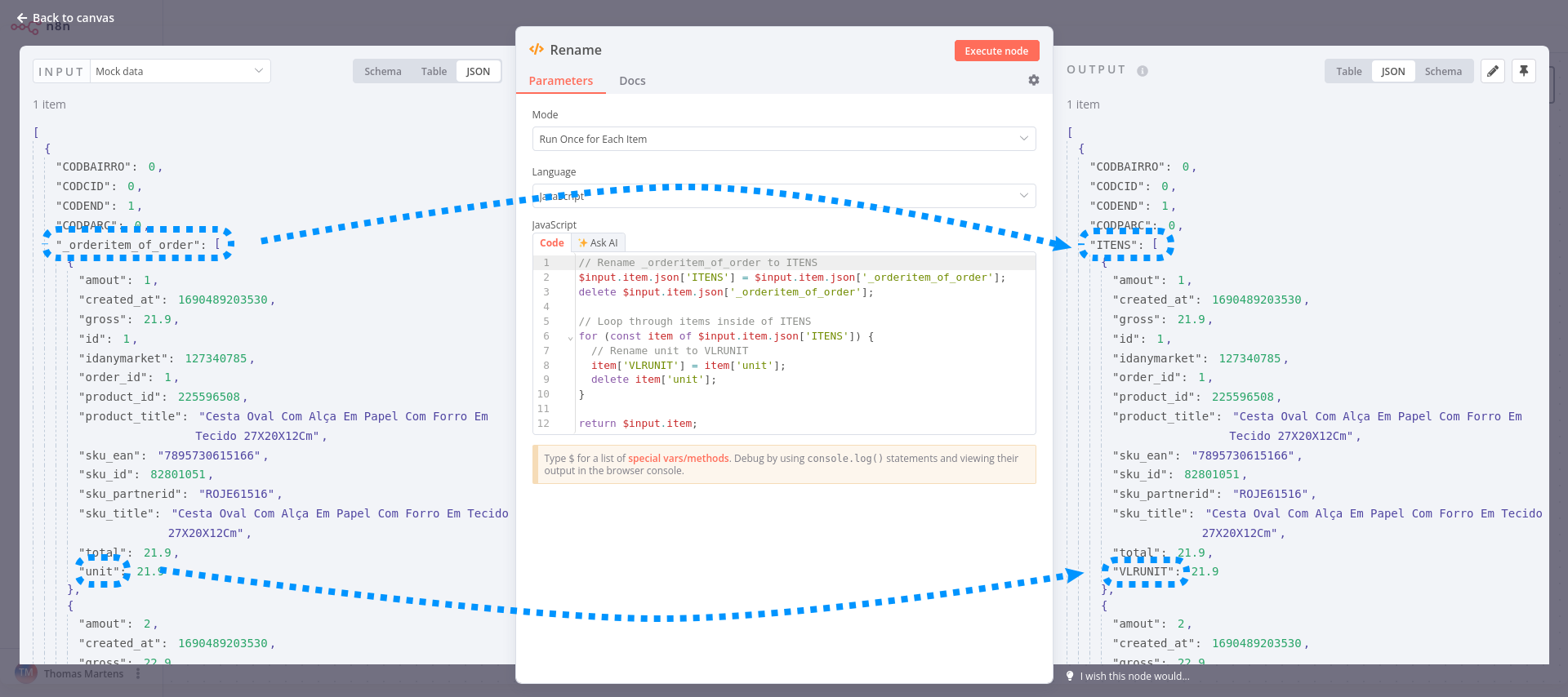

Hi @BrunoNonato, welcome to the community!
I am sorry you’re having trouble.
Just to confirm, you want to rename keys inside your _orderitem_of_order array, right (in addition to renaming the array itself)? I’m afraid the “Rename Keys” node can’t quite handle this, but the Code node can help you here. Assuming you want to rename unit into VLRUNIT, the below workflow would do the job:
This is the result:
Hope this helps :slight_smile:

Hi @MutedJam , sorry for the Portuguese, I didn’t pay attention.
But regarding the rename, it would be great if it worked inside the array.
On the other hand, the code solution you passed worked perfectly here.,
Thanks a lot for the help.
