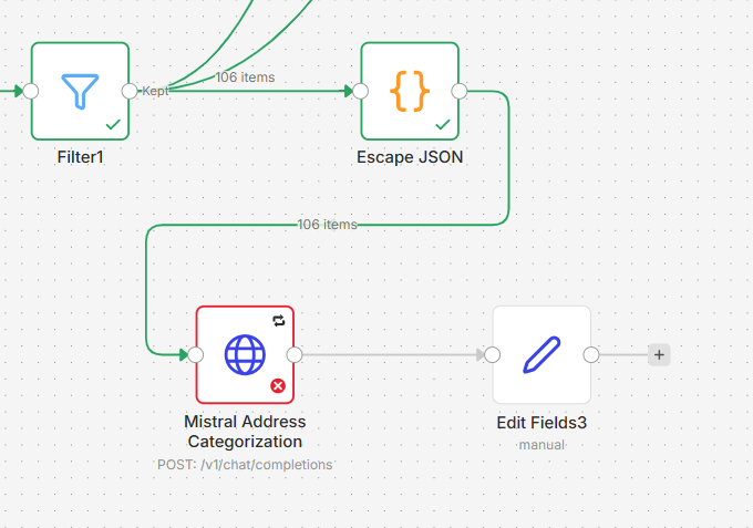

Here are my findings after trying your solution and doing other extensive testing:
  1. The Basic LLM chain always fails no matter what you give it. It throws the type error even after re-running the workflow, refreshing the page, using a small dataset…etc. I believe it is incompatible with v2 of n8n.
  1. The HTTP node using the same model is successful for a small list of items (5 items to be exact) but fails due to the default timeout for a larger payload (106 items). My guess is that n8n’s WAF is preventing additional requests beyond a mysterious number from being fulfilled.
I have given up on the Basic LLM Chain because it is clearly not going to work due to incompatibility. However, I have hope for the HTTP node. I have provided the input in my message, what other details would you like me to share?

Do not use the Basic LLM Chain in this scenario
Use a direct HTTP Request Node for the LLM
Add Split In Batches before the HTTP Request
Batch size: 5 or 10
Increase the HTTP Request timeout
Ensure the URL is always a literal string
Cancel pending executions and disable/re-enable the workflow
