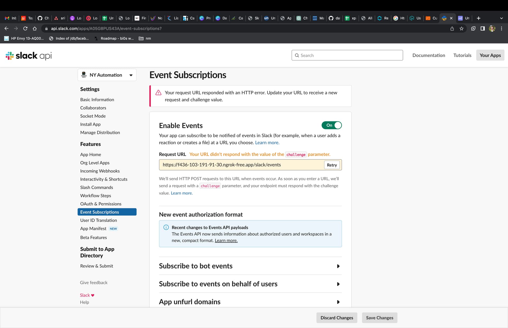

Request URL is not verified in the events subscription in slack integration

At the moment this issue could be a few different things like maybe the URL is wrong as it doesn’t have the webhook part of the path although this could be changed in your config, It could be that the workflow is not active or maybe the workflow is not returning the challenge correctly.
I have tested the URL quickly and I get the below back so I suspect ngrok is not correctly configured.
