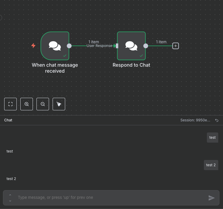

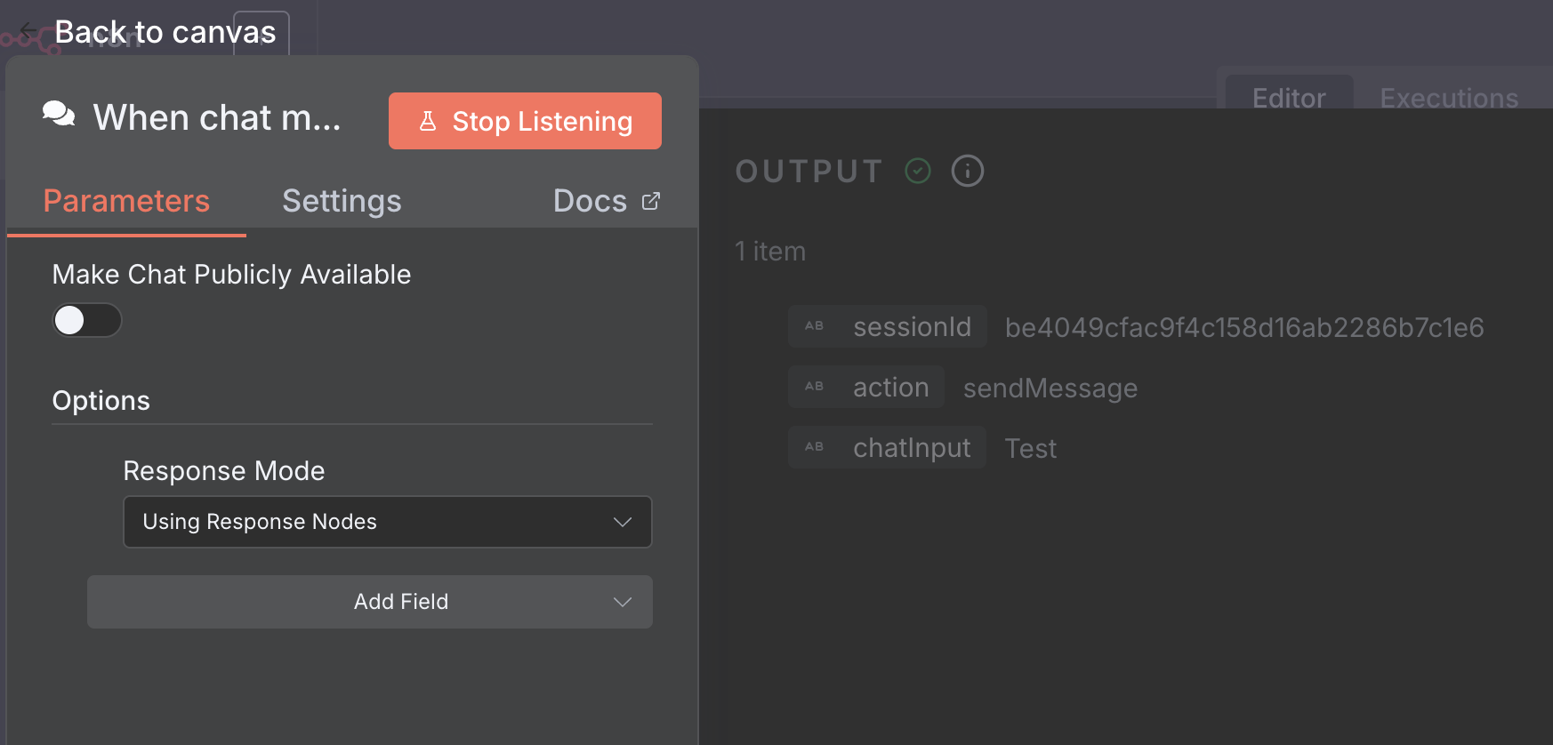

I simplified my worflow to just two nodes to demonstrate my issue:
Nodes settings:
It’s waiting forever.
I probably made a simple and stupid mistake - which one, please?
