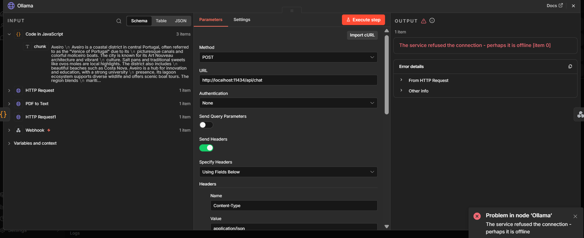

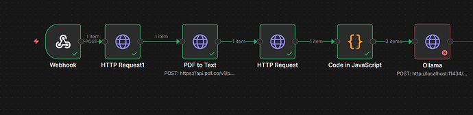

Good afternoon, how are you? Here’s the thing, I’m trying to create a workflow in n8n in which I send the pdf link through insonia and it returns a summary of the pdf but I’m having problems with ollama, any suggestions?
Version is the more recently and is localhost
Hi @Duarte_Palha
if you’re on docker, swap http://localhost:11434 for http://host.docker.internal:11434 in your ollama node. this tells n8n to look at your host machine instead of inside its own shell.
sometimes localhost resolves to ::1 (ipv6) but ollama is only listening on 127.0.0.1 (ipv4). i usually just use http://127.0.0.1:11434 to be safe and avoid that “ECONNREFUSED” headache.
ollama defaults to only allowing local connections. might be worth setting OLLAMA_HOST=0.0.0.0 in your system environment variables and restarting ollama so it actually listens to the docker network.
your workflow looks okay but you’ll need to make sure that “code in javascript” node is actually passing the full text chunk to ollama. if the text is too huge, ollama might timing out or rejecting the request entirely.

Hey @Duarte_Palha, a few things that might help:
1. Ollama can’t read PDF binary data directly
The most common issue here is sending the raw PDF to Ollama. You need to extract the text first. If you’re using n8n v1.30+, there’s an Extract from File node that handles PDF text extraction natively — add it between your HTTP Request (that downloads the PDF) and the Ollama node.
2. Workflow structure that works
Webhook (receives PDF URL via Insomnia)
  → HTTP Request (downloads PDF, set Response Format to "File")
  → Extract from File (extracts text from PDF binary)
  → Basic LLM Chain + Ollama Chat Model (summarizes)
  → Respond to Webhook (returns result)
3. Use the built-in Ollama nodes instead of raw HTTP
Instead of calling http://localhost:11434/api/generate manually, use the Ollama Chat Model node (under AI > Language Models). It handles streaming, timeouts, and response parsing automatically. Connect it as a sub-node to a Basic LLM Chain node.
For the prompt in the Basic LLM Chain:
Summarize this resume. List key skills, years of experience, and education:
{{ $json.text }}
4. Docker networking
If n8n runs in Docker and Ollama on the host, make sure you started n8n with --add-host=host.docker.internal:host-gateway and set the Ollama credentials URL to http://host.docker.internal:11434 instead of localhost.
5. Timeout settings
Ollama on CPU can be slow for the first request (model loading). If you get timeout errors, go to the Ollama Chat Model node settings and increase the timeout to 120 seconds.

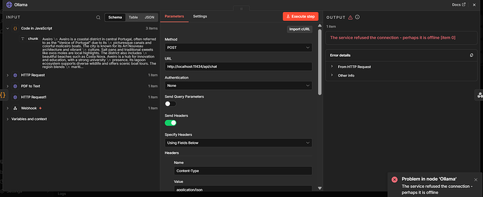

What specific error are you seeing? The screenshot shows “The service refused the connection” which usually means either Ollama isn’t running or the URL/port is wrong from inside Docker.
