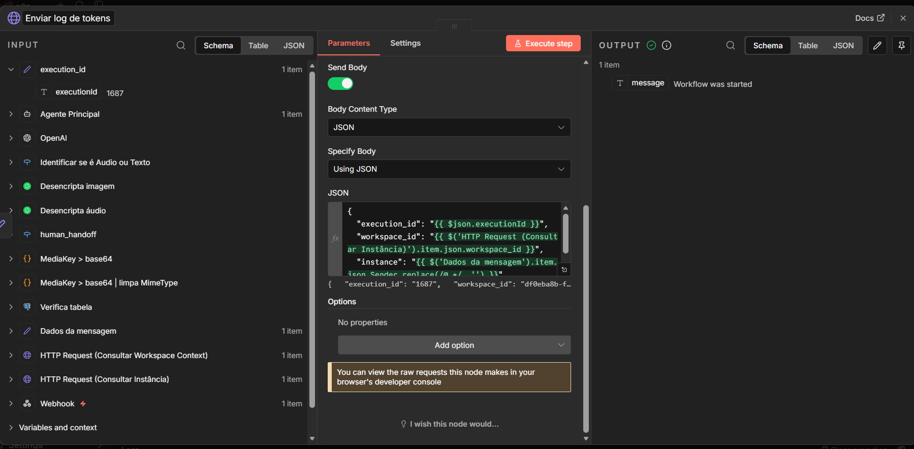

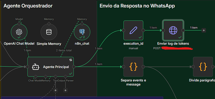

What I did was simply adding two nodes right after the Agent node (Edit Fields > HTTP request, bcs I was having some trouble with the Execute Sub-workflow node), as you can see below:
The Edit Fields node just filters the execution_id at the active workflow using {{ $execution.id }}.
The HTTP request node does a POST to {your_n8n_url}/webhook/log-tokens, with the following JSON body (in MY case, I also send together workspace_id and instance bcs these are UUIDs for my SaaS backend, for billing):
  "execution_id": "{{ $json.execution_id }}",
  "workspace_id": "...",
  "instance": "..."
BUT you’ll probably use only:

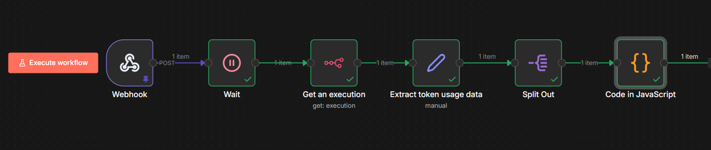

Then I created another workflow:
Basically, it has a Webhook trigger, that listens to the POST request did at the last workflow, listening path "log-tokens”:

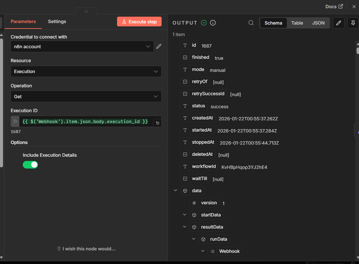

Then I added a Wait node of 5 secs just to make sure the workflow is over. Then Get an execution node:

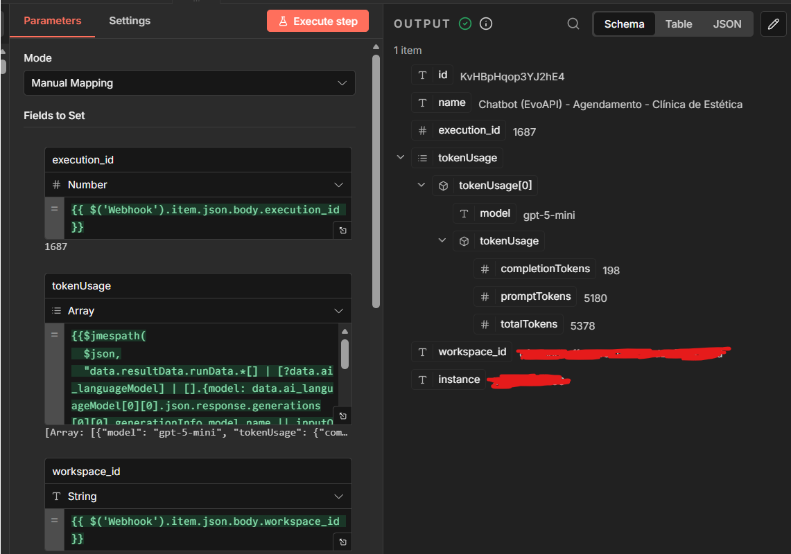

By this point, I already had the AI Agent tokenUsage, then I just used and edited the Edit Fields node made by @solomon after that to get the execution_id in Webhook, and to filter whatever else I needed for my implementation:
I also kept the Split Out intact as in the original as in @solomon’s solution.
Then I noticed the output value delivered by n8n is somehow completely inflated. After testing and checking directly at OpenAI Platform, I realized that specifically for OpenAI models there’s a ~1.6x increase in token usage in n8n in relation to the number displayed at the official OpenAI API data (and it’s actually what’s used for billing).
