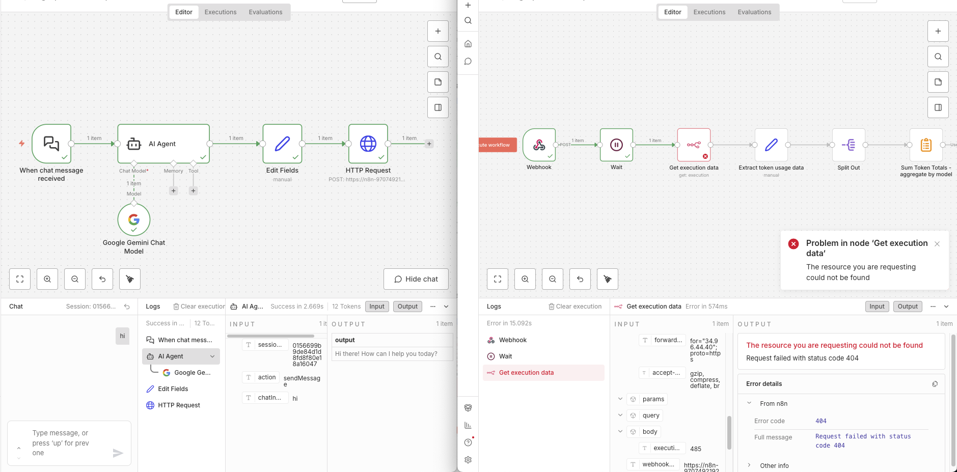

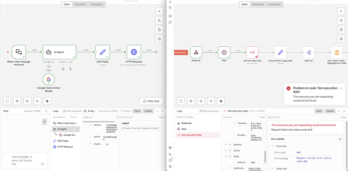

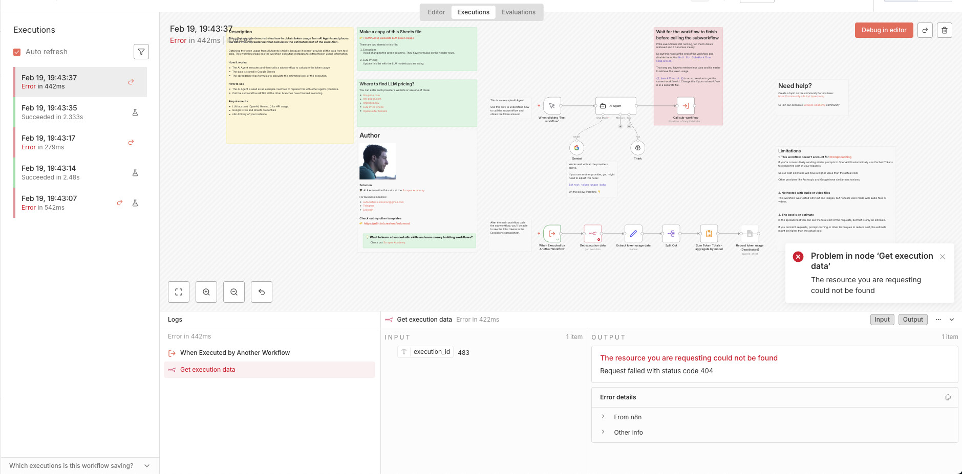

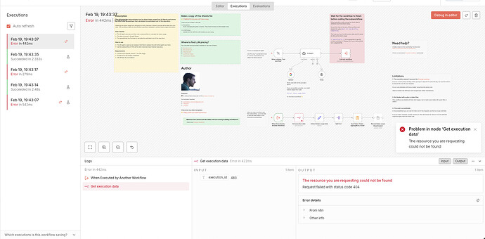

I did try both @solomon and @filipeleal suggested solutions, but I keep getting the error “The resource you are requesting could not be found".
Do I need to have the paid version of n8n for it to work?

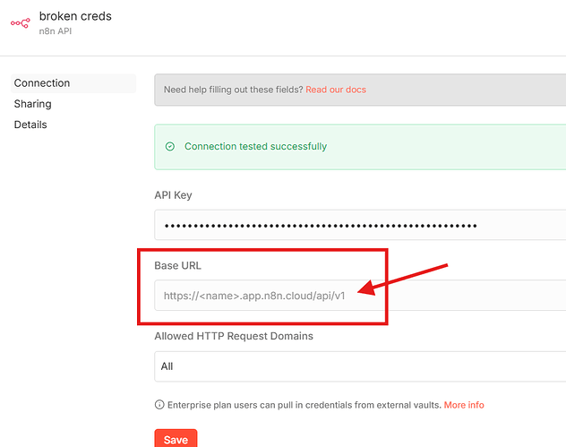

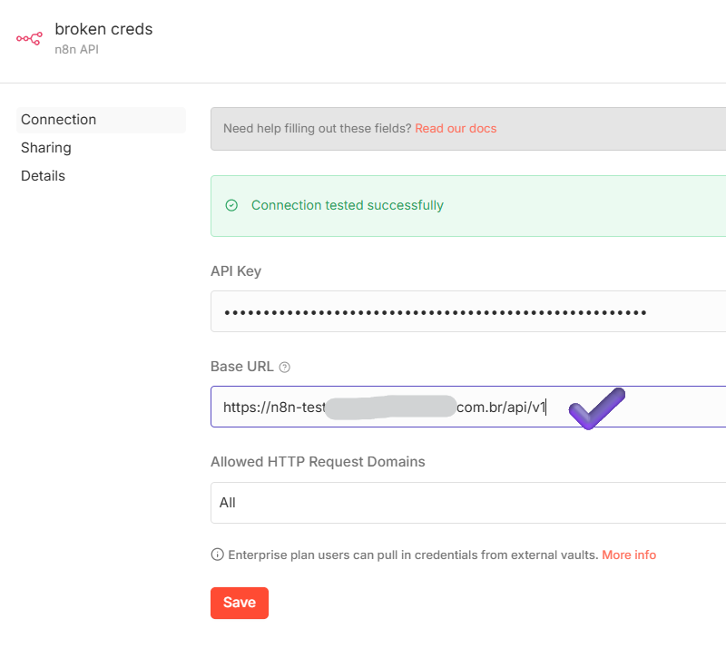

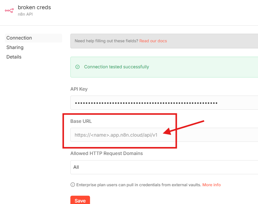

Hey @andre2026 , it could be the URL in your credentials. Yesterday I helped another user with the same problem, and it was the credentials.
You must include “/api/v1” at the end of the base URL of your credentials. Exactly as shown in the example placeholder for that field.

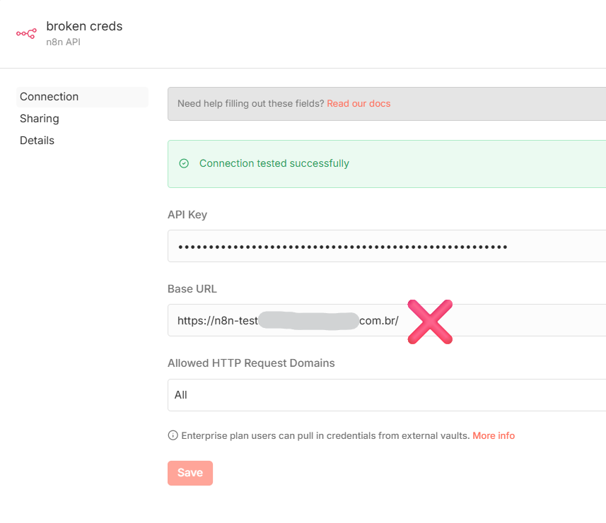

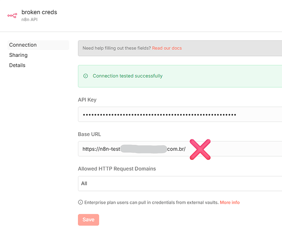

Thank you very much @solomon!
It wasn’t the missing “/api/v1”, but it was indeed an error on how I wrote the base url.
Thanks for your help. It is working now!
