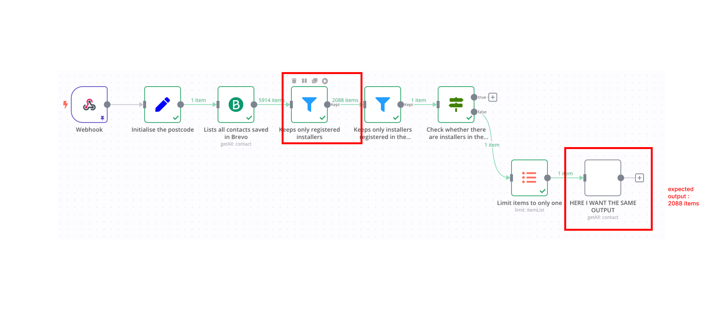

Well, then I’ll try to describe it to you in more detail. The aim of my workflow is to determine the nearest installer of a building product, when a prospect requests a quote. The prospect gives his postcode, and we know the postcode of each of the installers.
So first we need to see if there are any known installers in the department, and if not, look in the departments bordering the postcode entered by the prospect.
In the first “IF” node, if the output is true, this means that there are one or more installers in the department. In the opposite case, if the output is false, this means that there are no installers in the prospect’s department, so we have to run the machine again, but for the departments around (bordering).

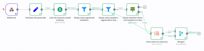

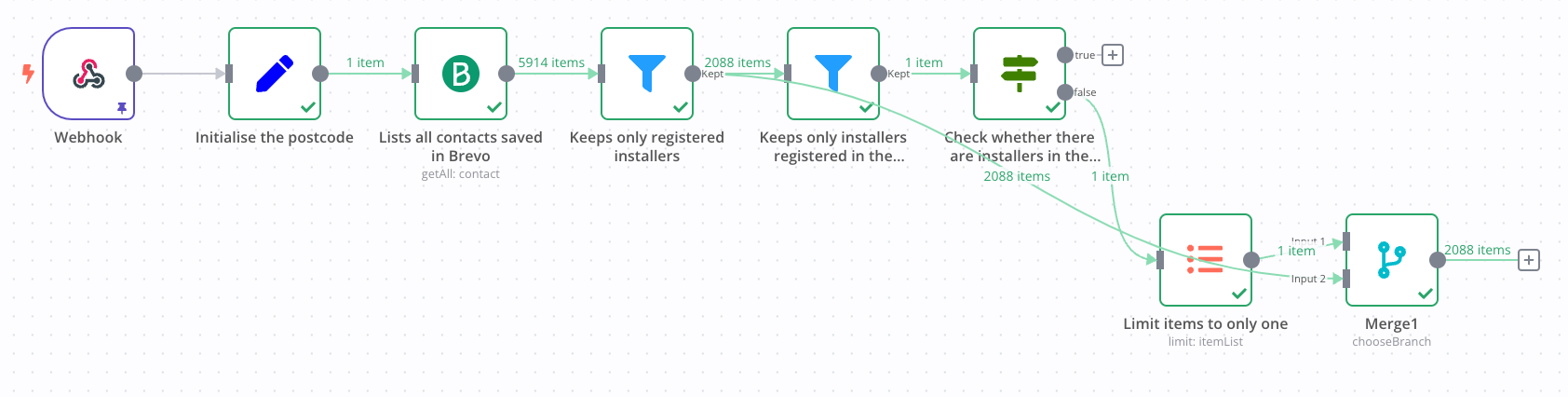

So I have to repeat the same operation (same call to Brevo) and reapply the same filters, because their API doesn’t allow you to do it any other way. What I’d like to get back is exactly the same output as my first filter node (with 2088 items).
Have you tried a merge node from the filter and item lists node? That would give you the items to use again.
You could also do both searches at once and work out the response from there.
Works perfectly! Although I use this solution a lot, I hadn’t thought of it! Thanks a lot :slight_smile:
