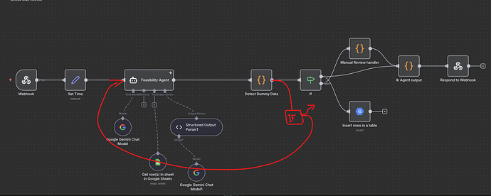

You can create a loop branch:
Also, be careful to handle the possibility of an infinite loop.

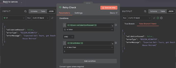

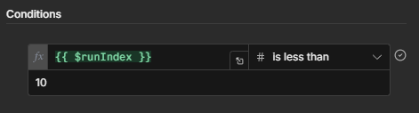

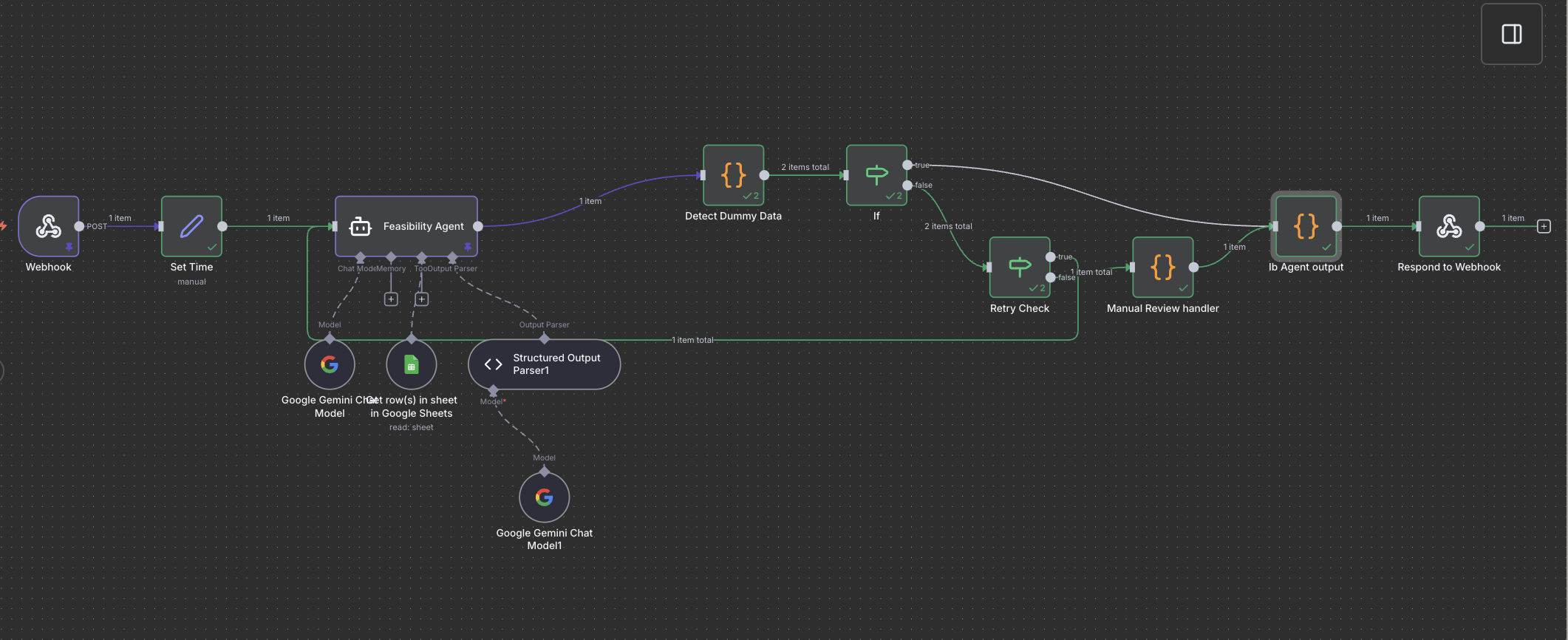

i tried the same it really goes in infinite loop, i try to setup the attempt counter but unable to achieve the result
thanks a ton bro
URW @rajnish_sharma , feel free to push that button, it’s free dopamine for me ![]()
