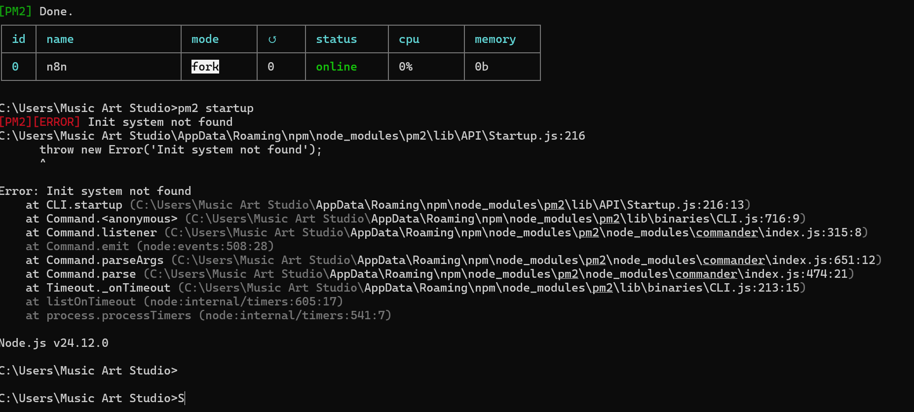

Hi. Installed N8N with npm. I get an error when wanting to install as a server after executing cmd → pm2 startup:
