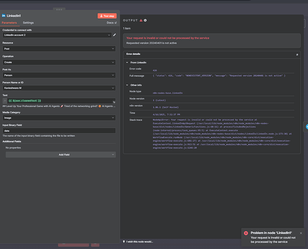

yeah i have solved it and i have another issue
why can’t i connet my linkedin and my self host url and how to solve it can u help me
This error indicates that the version passed in the request header X-LinkedIn-Version has been deprecated (e.g., 202401). This occurs because all versions are scheduled for deprecation after a specific time window (e.g., 12 months). Refer to the Sample Response for more information.
So It might be that the LinkedIn node uses the deprecated API.
But you can use the HTTP Node and control which API url to use.
Further information can be found
https://community.n8n.io/t/step-by-step-guide-how-to-post-to-linkedin-via-n8n-automations/61666
There seems to be reported problem on github with a workaround for those working in Docker.
https://github.com/n8n-io/n8n/issues/14678
or use this solution as I described (HTTP Node)
Changing the API version on docker
line 41 of GenericFuntions.js
"LinkedIn-Version": "202504"
Then stop your app and restart
if you think this solves the problem (for now) please hit the SOLUTION button
