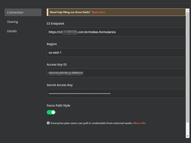

Do you have the force path option enabled in the credential that may help?
I’ve activated this option now to test it. When I test it now, the request stops giving an error, but it doesn’t return anything
Stopping by to update this thread.
After much research into Minio, I discovered that it places the bucket directory as a slug, whereas it should be a subdomain.
MinIO = s3.mydominio.com/bucket
By doing this I was able to consume the Minio api that I hadn’t been able to in the original post
