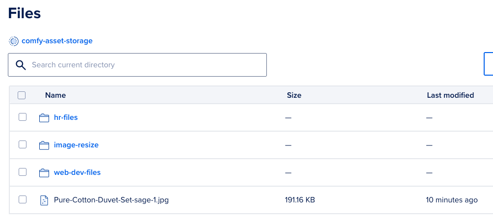

When using the S3 node. It allows me to define:
Resource: File
Operation: Get Many
Bucket Name: my-bucket-name
Inside that bucket are various folders, one of them called image-resize. I want N8N to get all images inside that folder. But there seems to be no option, it will grab images from the parent bucket though.
No error, just nothing returned because it’s looking for images at the bucket level and not within the folder I need it to.
It does not reach that far, I’m blocked by the first step of just getting images from S3/Bucket folder. If at all possible?
Example: It would be able to find the .jpg from this level. But it can’t go into the image-resize folder to find the images I actually want it to grab.

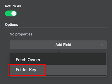

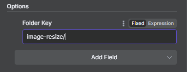

Hi you can use option > folder key
You must use end prefix with (/) so it will works and you can target all subchild folder too just make sure you end it with (/)
