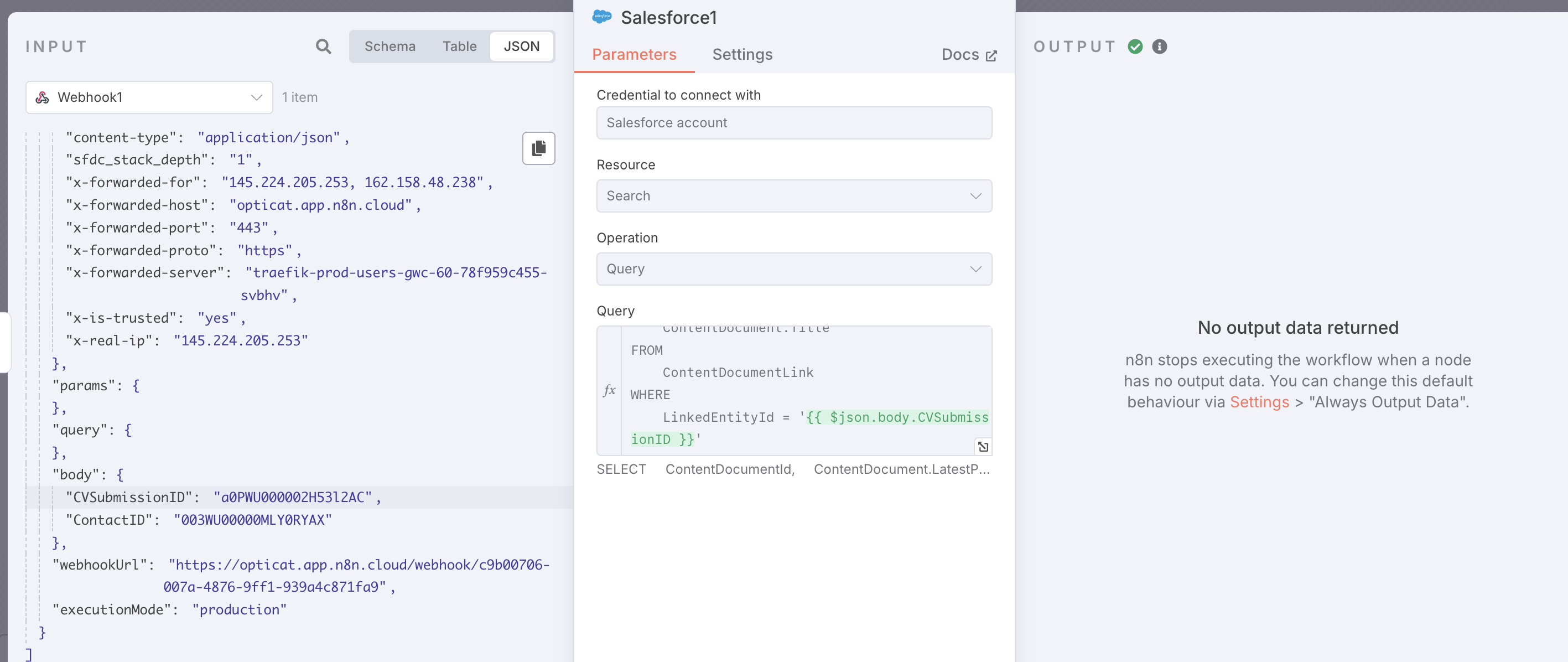

Problem: My “Salesforce1” node consistently returns “No output data returned” when using a dynamic expression for the SOQL WHERE clause, even though the exact same query, with the exact same ID, yields a successful result in the Salesforce Developer Console. When I hardcode the ID directly into the Salesforce node’s query in n8n, it works perfectly.

  1. Salesforce1 Node: Configured to “Search” and “Query” the ContentDocumentLink object.
  • SOQL Query: SQLSELECT ContentDocumentId, ContentDocument.LatestPublishedVersionId, ContentDocument.Title FROM ContentDocumentLink WHERE LinkedEntityId = '{{ $json.body.CVSubmissionID }}'
  • The alwaysOutputData setting on this node is currently false.

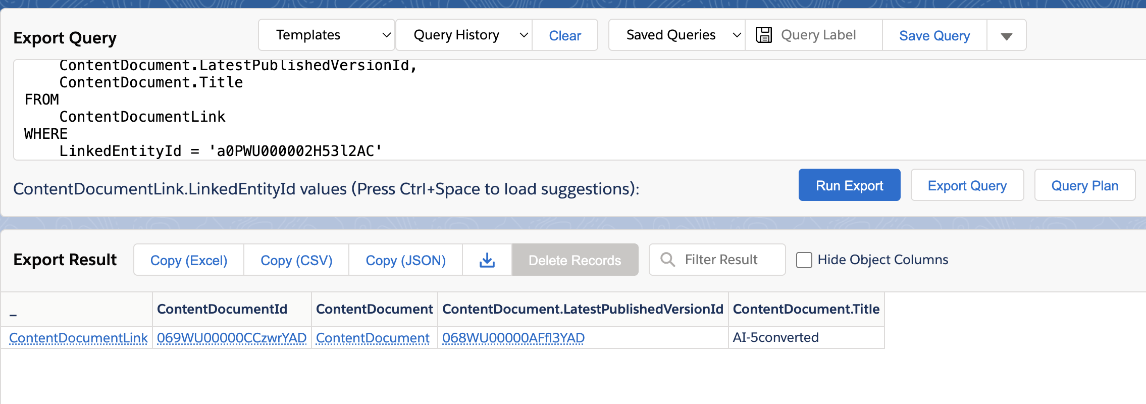

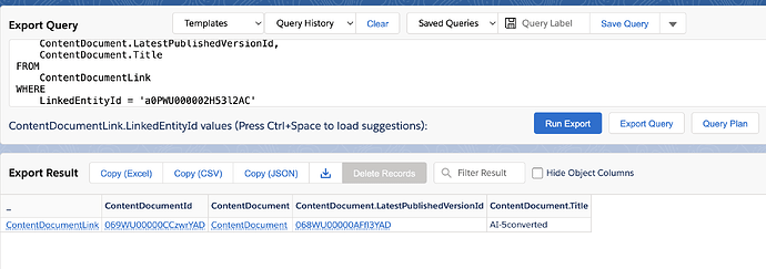

  • Salesforce Developer Console Test: I copied the CVSubmissionID from the Webhook1 input (e.g., a0PWU000002H53l2AC) and ran the SOQL query directly in the Salesforce Developer Console: SQLSELECT Id, ContentDocumentId, ContentDocument.LatestPublishedVersionId, ContentDocument.Title, LinkedEntityId FROM ContentDocumentLink WHERE LinkedEntityId = 'a0PWU000002H53l2AC' This query successfully returns 1 record in the Developer Console, confirming that the record exists and is accessible via this query and ID.

  • Dynamic Expression Failure: When using {{ $json.body.CVSubmissionID }}, the Salesforce node outputs “No output data returned.”
  • Input Data Validation: I have verified the input to the Salesforce1 node in n8n (via the “INPUT” tab in the execution view) and the body.CVSubmissionID is present and appears correct.
