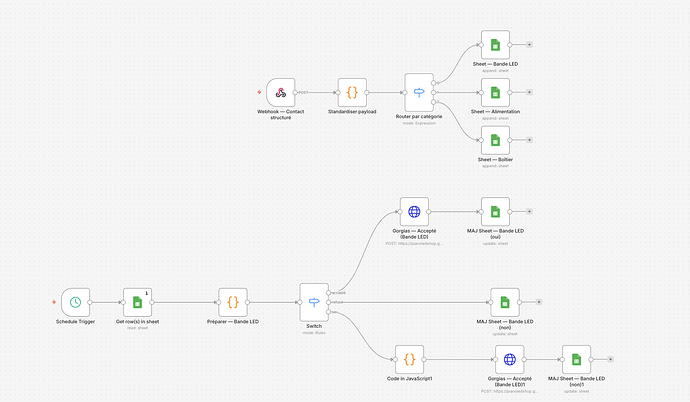

What my workflow does:
I have a customer support automation system. When a customer submits a support request, the data goes into a Google Sheet. A manager then reviews the request and fills in a “Decision” column (accepted / refused / escalate).
I have 3 workflows, each polling a different tab of the Google Sheet every 2 minutes:
  • Schedule Trigger (every 2 min)
  • Get all rows from Google Sheet
  • Code node: filter rows where Decision column was just filled in AND hasn’t been processed yet
  • Switch node: route based on the decision value
  • Actions: send email to customer, update sheet status, create support ticket, etc.
    So most of the time, the workflow runs, finds nothing to do, and stops. Only when the manager fills in a decision does it actually do something.

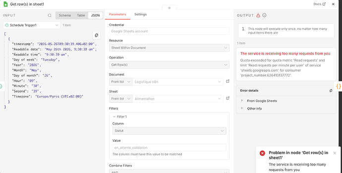

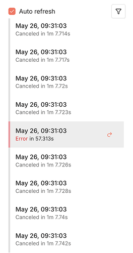

    I’m seeing way too many executions piling up. When the server restarts, I get a huge burst — dozens of executions all at the exact same timestamp, a mix of Errors (~40s) and Canceled (~1m7s).
    I think n8n might be trying to “catch up” on all the missed scheduled runs while the server was down. Or maybe the trigger is firing multiple times concurrently before the previous execution finishes.

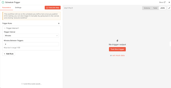

For the parameter on the Schedule Trigger — where exactly is the setting to disable catching up missed executions? I don’t see it in the node settings.

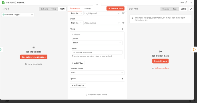

Also very interested in the Google Sheets Trigger approach — my workflow actually filters exactly on the “Decision” column: it retrieves all rows with the pending_validation status and checks if the “Decision” column has been filled. Can the native trigger specifically monitor this column and fire only when a new value is added to it?

To disable catch-up, open your Schedule Trigger node and look for the “Fire on startup catch-up” toggle - it’s in the node settings panel. Turn that off and n8n will stop trying to run all the missed intervals on restart. This is the cleanest fix for your use case since you’re polling every 2 minutes and a catch-up burst doesn’t make sense for a support queue.
Thanks but I can’t find it :slight_smile:
@Arthur_Mascot which version are you on? this is v2.21.7
