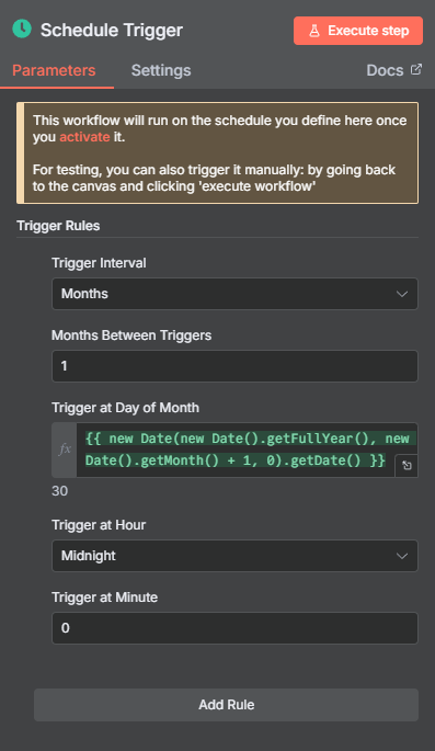

Hello @Cobal
I think you can determine the last day of the month dynamically using JavaScript,
For example, you can get the number of days in the current month with this expression
{{ new Date(new Date().getFullYear(), new Date().getMonth() + 1, 0).getDate() }}
which you can then use this value in the Trigger at Day of Monthfield:
