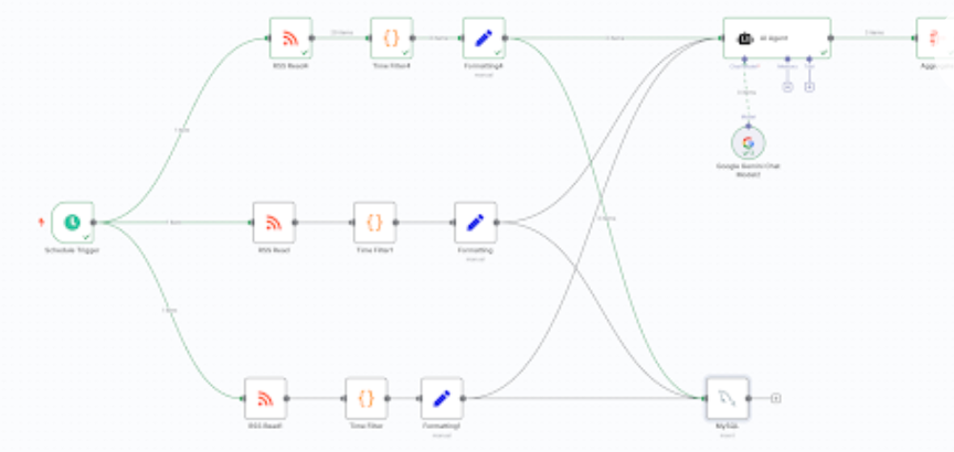

I’m encountering an issue with my workflow execution and would appreciate some guidance. My workflow is designed to read articles from three different WeChat official accounts (each with its own RSS feed). After reading and some initial formatting, the data from all three branches is then merged for two purposes:
  1. Sending original article content to a large AI model for summarization and then saving to Google Drive.
  2. Directly storing the original article content into a MySQL database.
    The Problem:
When the workflow is initiated by the Schedule Trigger', only one of the three branches (the top one in my screenshot) seems to execute fully (I attached the preview of my workflow below). The green lines coming out of the Schedule Triggerindicate that an Item is indeed passed to all threeRSS Readnodes. However, after the initialRSS ReadandTime Filternodes, only that single branch (the one that runs) actually passes Items further down the workflow. The other two branches show0 Items` in their subsequent nodes, indicating they are not actively processing or outputting data.
My Observation:
Strangely, if I manually execute** the AI Agent node (which is downstream from the merge point of all three branches), it successfully triggers all three upstream branches. It correctly retrieves data from all Formatting nodes, indicating that the RSS Read, Time Filter, and Formatting nodes on all branches are functionally capable of processing data when explicitly requested by a downstream manual trigger.
My Question:
Why does the Schedule Trigger fail to activate all parallel branches effectively, while a manual execution of a downstream node successfully processes data from all branches? What is the correct way to ensure that the Schedule Trigger reliably activates and processes data through all three parallel RSS reading branches?
