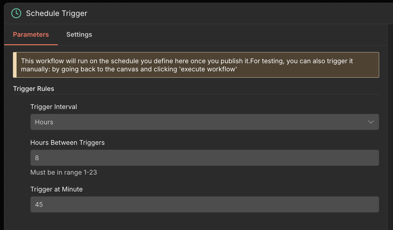

On n8n cloud, I have a workflow where the Schedule Trigger is set to Trigger Interval: “Hours”, Hours Between Triggers: “8”, Trigger at Minute: “45”.

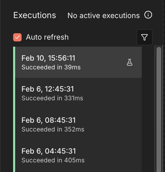

This execution has not triggered in 5 days now. What would cause this to happen? How do I debug if workflow is not even starting? Is scheduling reliable on n8n cloud? This node never triggered after changing it to 8 hour interval, up from 4 hours.
Workflow is active/published, I am on Starter (Annual) Plan, we are not over execution limits. Instance has not been rebooting that I can tell (how to see uptime?), other executions that are more frequent, or less frequent, have been running.
I noticed the problem under a previous n8n version, so I updated it to 2.6.4 (Latest Stable), which restarted the instance. This workflow still has not triggered at all, so clearly there is some kind of problem. How to investigate? Are there logs? I can’t see anything relevant on n8n cloud settings. The node version says “Schedule Trigger node version 1.3 (Latest)”. I don’t see anything in Known Issues in the forum about schedule triggers entirely failing to run? Don’t know where else to check for a problem like this.
Node config:
Prior executions (One manual test Feb 10, no production executions since Feb 6th):

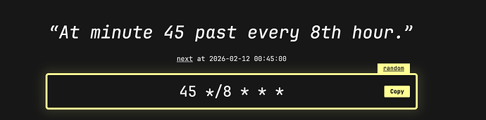

Hey Just a sanity check here, From my exp. using cron jobs are more reliable instead selecting the time in the schedule trigger. Can you try using a Cron job once and let me know if still errors or doesnt run for you.

Ok thanks for the suggestions. First I re-published it using Hours Between Triggers: 2, and it started executing again.
I changed it back to 8 hours, re-published, and it again failed to execute. I will try the cron method now, hopefully that will work.

Thanks everyone, the cron method did work in this case, marked as solution.
