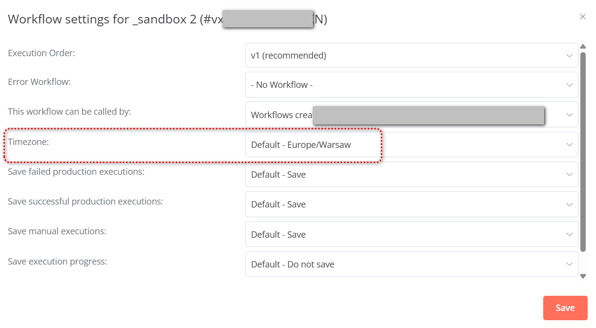

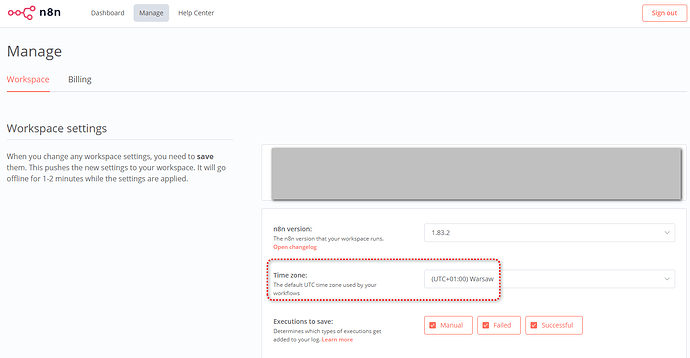

What do your workspace settings have for TZ? https://app.n8n.cloud/manage
Another place to look into is specific workflow’s settings.
kdenes
3
Thanks. Modified the default and workflow timezone. I think this will solve it
