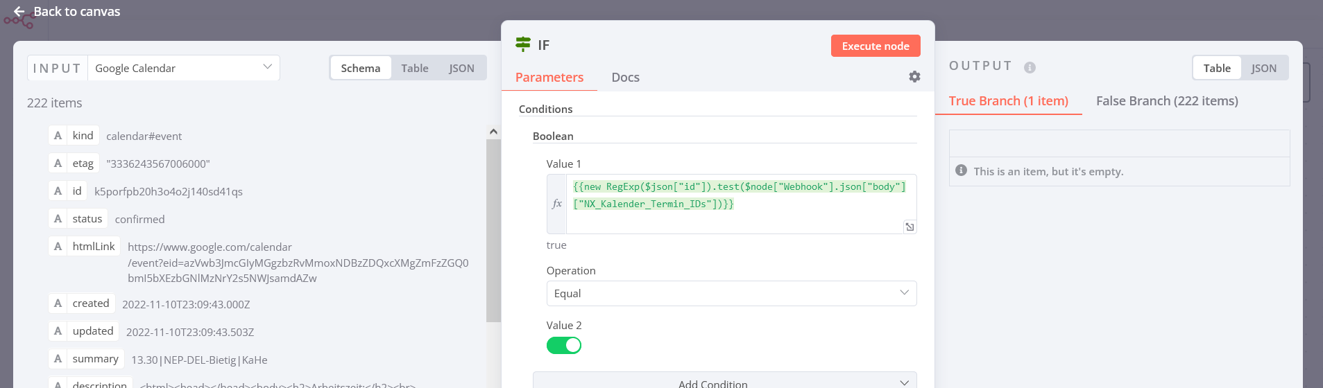

I want to check if these are in a text file, if I do it without variables it works, as soon as I do it dynamically it doesn’t work anymore.
is not works:
{{ /$json["id"]/i.test($node["Webhook"].json["body"]["IDs"])}}
is works:
{{ /k5porfpb20h3o4o2j140sd41qs/i.test($node["Webhook"].json["body"]["IDs"]) }}
what is my mistake?
This is more about how Javascript works. You should be able to do this using new RegExp() instead:
{{ new RegExp($json["id"]).test($node["Webhook"].json["body"]["IDs"]) }}
Here’s an example:
thanks sirdavidoff, unfortunately it doesn’t work either, there should be 12 hits. Does anyone have a suggestion?
or
another try with ‘code’:
for (const item of $input.all()) {
  item.json.myNewField =  RegExp(["ID"]).test(["IDs"])
return $input.all();
what else could it be, does anyone have an idea?
