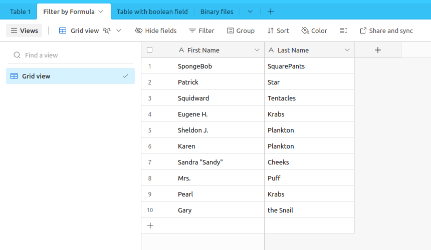

So searching in Airtable using n8n is also possible, but that’s a bit hidden. You’d need the List operation of the regular Airtable node and can then add the Filter By Formula option.
For example, assuming this is your Airtable table:
You could find Patrick using n8n’s Airtable node like so:
Hope this helps :slight_smile:
