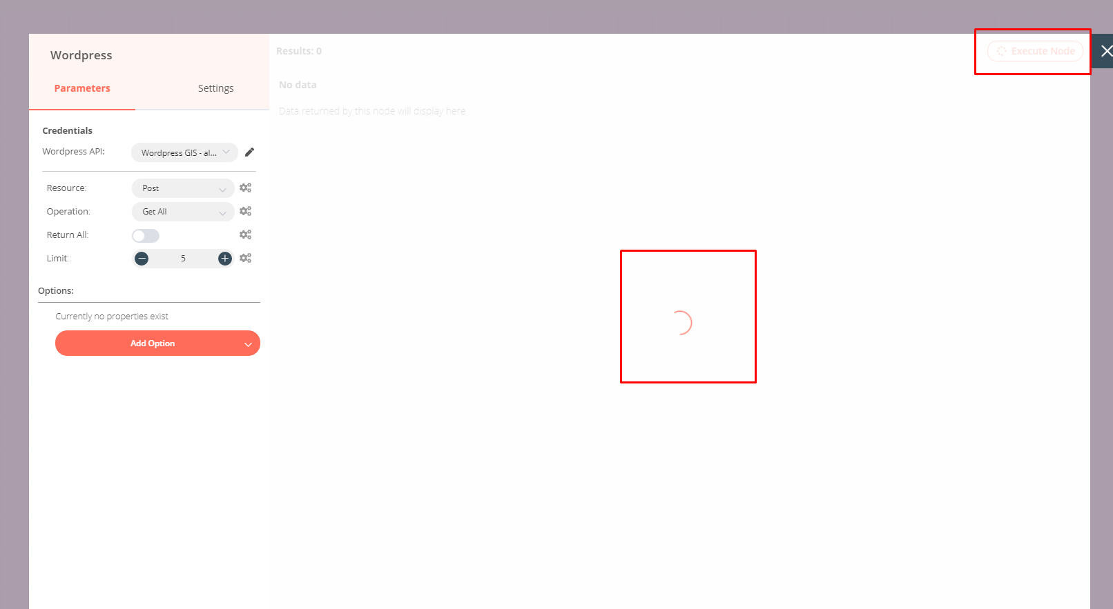

Sorry. The issue we have (apart of the hang after activating the imap module) is that in all worflows, while we are designing and “execute node” we never get the returned result, successfull or not. We can then review afterwards in the executions tab but not within the designer. Therefore we can not see the resulting object and therefore can not map it to the next node while designing.
As you mentioned we must have an issue with the return of the execution result. I did not mention earlier that our NGINX front proxy is on another server on the network that upstreams to our docker server on the port where n8n is working. Perhaps this is an issue or somehow the “public” name for n8n should not be the external one.
Hope that, clarifies something. I attach some screenshots.
Still stuck with this last error. Seems like the execute workflow on the editor never get a return to the interface. Could you point any tip on how to debug it. Any specific Nginx configuration required that we might be missing on the proxy?Thanks
