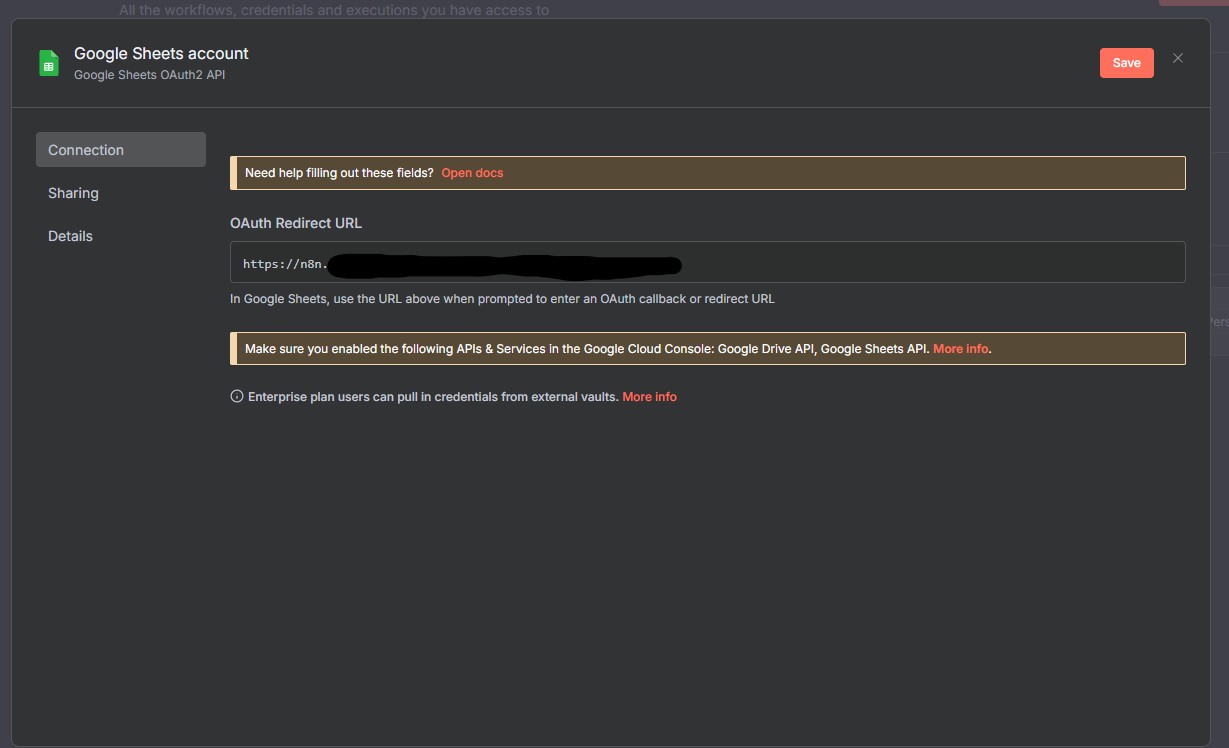

Hi everyone,
I’m facing a strange UI issue when trying to set up Google OAuth credentials on my self-hosted n8n instance, and I’m hoping for some guidance.
When I go to the n8n UI to add a new credential (e.g., for Google Sheets), the modal window is almost empty. Crucially, the input fields for ‘Client ID’ and ‘Client Secret’ are completely missing, and the ‘Sign in with Google’ button is also not displayed. Instead, I only see a generic “Please check the errors below” message, with no way to proceed.
I understand that in modern self-hosted versions, the fields are supposed to be hidden in favor of a “Sign in” button when environment variables are used. However, I’m getting neither.
Any help or ideas would be greatly appreciated!
Thank you.

Hey @heivwendell
please see if you have N8N_DEFAULT_LOCALE env variable specified in your environment. There is a known issue, where having this env var causes some fields to disappear. If you do have that specified, please remove it and restart your instance.
Thanks! Worked here
