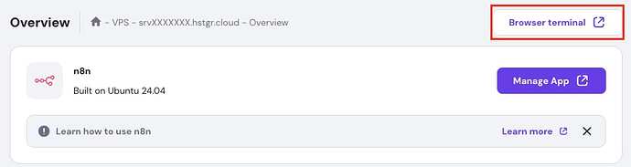

OK i just resolve the issue. Hoping could be helpful I did the backup directly on Hostinger.
There are directions in the Hostinger control panel on updating N8N.
Access your VPS through a browser terminal:
  1. Pull the latest version of the n8n image:
    docker compose pull
  2. Stop and remove the currently running containers:
    docker compose down
  3. Start n8n with the updated image:
    docker compose up -d
That’s it! Your n8n instance should now be running the latest version. You can verify the version by accessing the n8n dashboard
