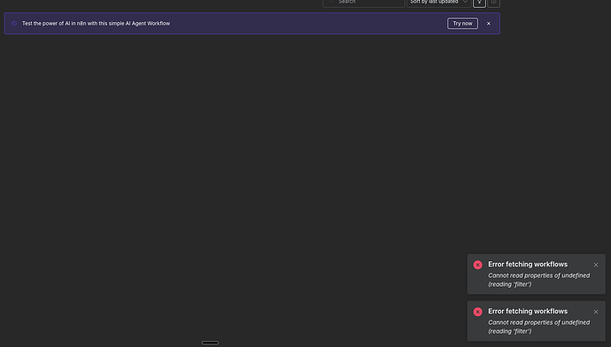

Another issue I could spot is that for one of my projects, it fails to list of workflows, although credentials display just fine. :person_shrugging:
Might be related to 1.106.3 since I reverted to that (new) version that was published today, I believe

I still can’t open/edit any node on any workflow, and one of my projects doesn’t display the list of workflows unless I apply a filter.
Error fetching workflows
Cannot read properties of undefined (reading ‘filter’)
