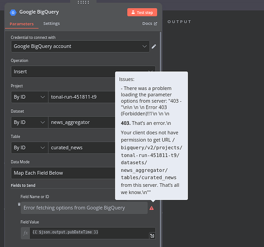

I have a problem when authorizing access to BigQuery and Google Gemini nodes in my workflow. I use the same workflow in the cloud version, and everything works well. However, when I tried the exact same workflow in a self-hosted N8N instance within Coolify, it refuses to authorize my access. Google BigQuery node was authenticated using OAuth2, as suggested by the documentation. Google Gemini node was authenticated using API Key from Google AI Studio, also as suggested by the documentation.
This is the associated error logs obtained from N8N canvas for BigQuery node:
Issues:
    There was a problem loading the parameter options from server: "403 - "\n\n \n \n Error 403 (Forbidden)!!1\n \n \n
    403. That’s an error.\n
    Your client does not have permission to get URL /bigquery/v2/projects/tonal-run-451811-t9/datasets/news_aggregator/tables/curated_news from this server. That’s all we know.\n""

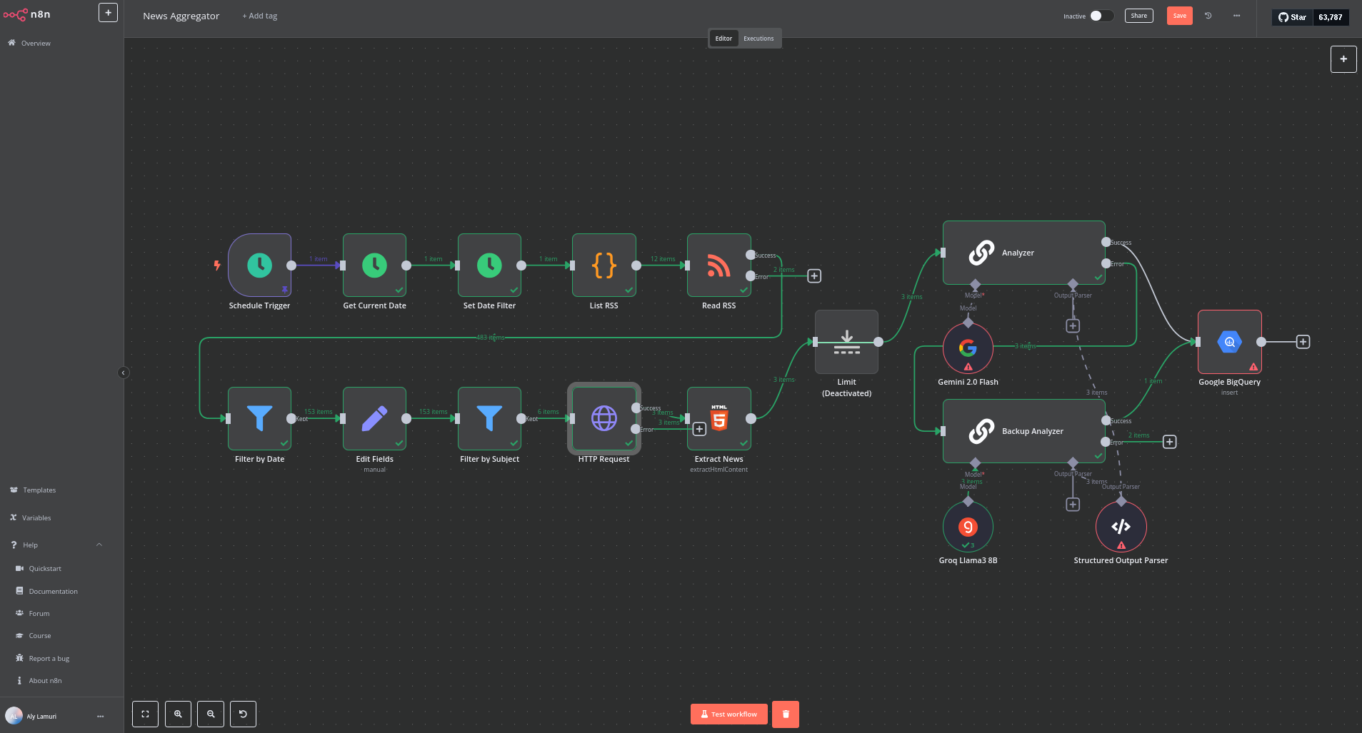

Update: I tested the workflow without resolving the issues with Gemini and/or BQ. There appears to be a problem when sending an HTTP request from N8N. The workflow can fetch data from the internet, as we see in the successful Read RSS node. But it can’t send an HTTP request.
Forbidden - perhaps check your credentials? [item 2]
ERROR: The request could not be satisfied 403 ERROR The request could not be satisfied. Request blocked. We can’t connect to the server for this app or website at this time. There might be too much traffic or a configuration error. Try again later, or contact the app or website owner.
If you provide content to customers through CloudFront, you can find steps to troubleshoot and help prevent this error by reviewing the CloudFront documentation.
Generated by cloudfront (CloudFront) Request ID: pXdNthx9YaocG3VDyBxI2I4MYi1_6nSnmHScjmGYGkQKss7i8P0ilg==
The errors occur when accessing specific URLs. I reconfigured the node to continue on errors, and as expected, it’s able to hit Groq API but unable to hit Gemini nor BQ APIs.
