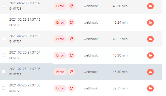

There doesn’t seem to be a major influx of these at the time of error, just a few per minute. Here is one block of errors with long run-times:

Anyway, looking at your screenshot would it still probably not totally fix your problem. Do you know why those jobs run so long? Is there any kind of loop in them or anything else which could cause the jobs not to stop?
