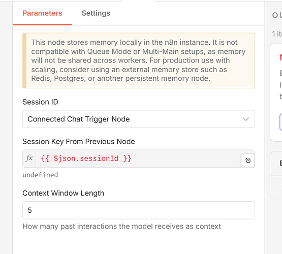

Hi @Justin_Davey I see the issue, in that simple memory node set the sesssion id to connected chat trigger node i mean which is the default value which will come automatically if you remove and re add that node.
Thanks @Anshul_Namdev . Appreciate the quick response! I deleted and re-
added. It worked the first time I ran it but then i got the same error on attempt 2. Here’s the display.

@Justin_Davey understood, have you tried manually setting the simple memory by define below property and entering this {{ $('When chat message received').item.json.sessionId }} so that you are manually telling it what to actually be look upto this is same as the default but this time you have manually set that as an expression.
One important check: make sure you’re testing through the chat bubble icon on the Chat Trigger node (the built-in test chat), not via the “Test Workflow” button — clicking “Test Workflow” doesn’t fire a real webhook and therefore doesn’t generate a proper sessionId. If you’re already using the chat UI and it still fails, try setting Simple Memory’s Session ID mode to “Custom” and manually entering {{ $('When chat message received').item.json.sessionId }}.
