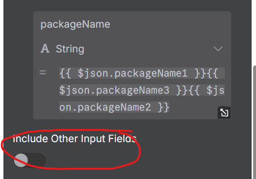

Hi, i think you forgot to set this:
reg,
J.
Where do I set that?
It’s an option/toggle in the last set node (below the fields)
Even though address and package name work now, I still seem to get a “null” on the formatted dates, despite having turned it on on all the Set Nodes I had…
