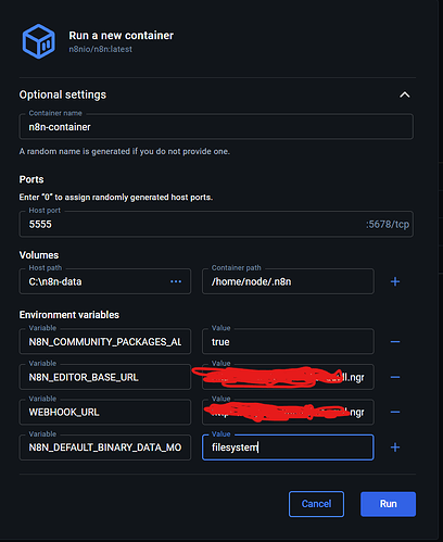

When I set to active production, no execution is running at all. Do you know why this is behavior is occuring? If I run with test execution, it has no problem to work.
Current n8n container ENV settings:
No error.

  • n8n version: Latest
  • Running n8n via (Docker, npm, n8n cloud, desktop app): docker self hosted
  • Operating system: Windows
