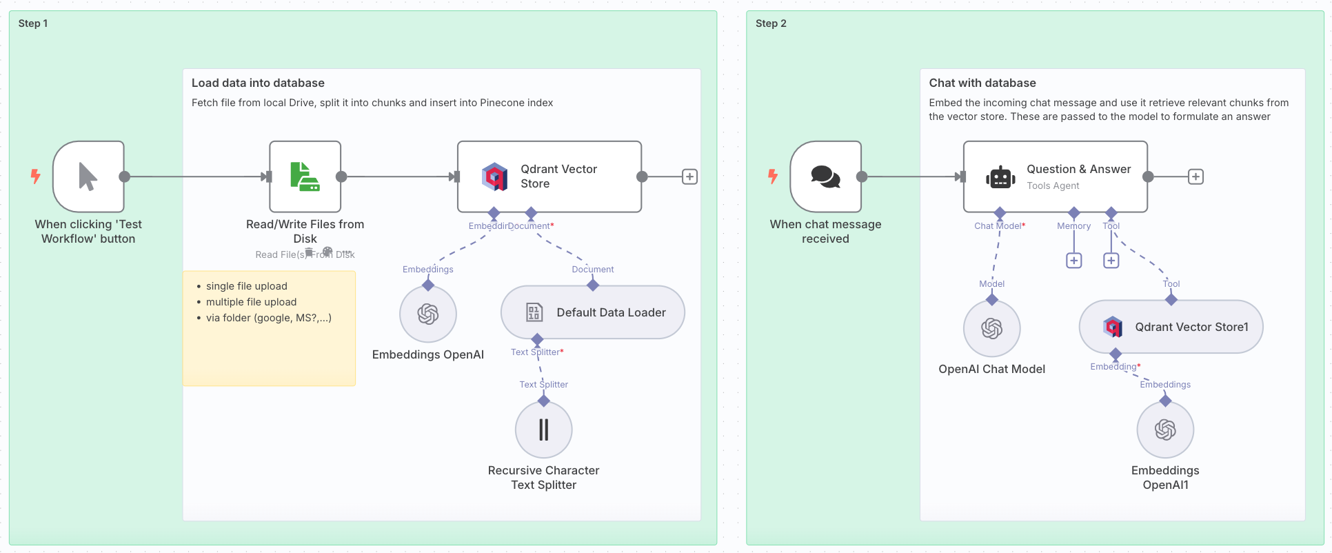

Thanks to my workflow I uploaded a simple instruction manual in PDF.

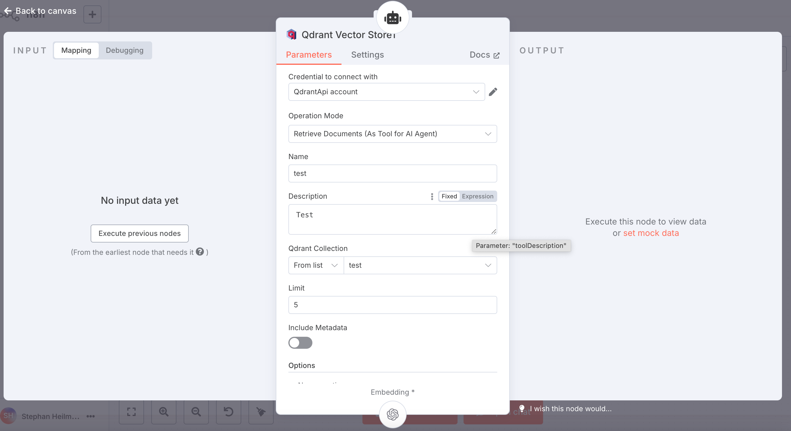

When I execute the Chatbot, I only get generic openAi answers not linked to uploaded PDF in qdrant vector store, even I configured to “retrieve”… Any suggestions why it might not work? Due to local installation? Wrong Vectors Configurations (Dot, Cosine,…)?
Step2, detailed screenshots:
Hi,
Text-embedding-small needs something like 15xx size
Large might need 3072 as you configured. I think you are mixing and matching size
Also not sure if you can inject pdf directly or you need to extract the data first
