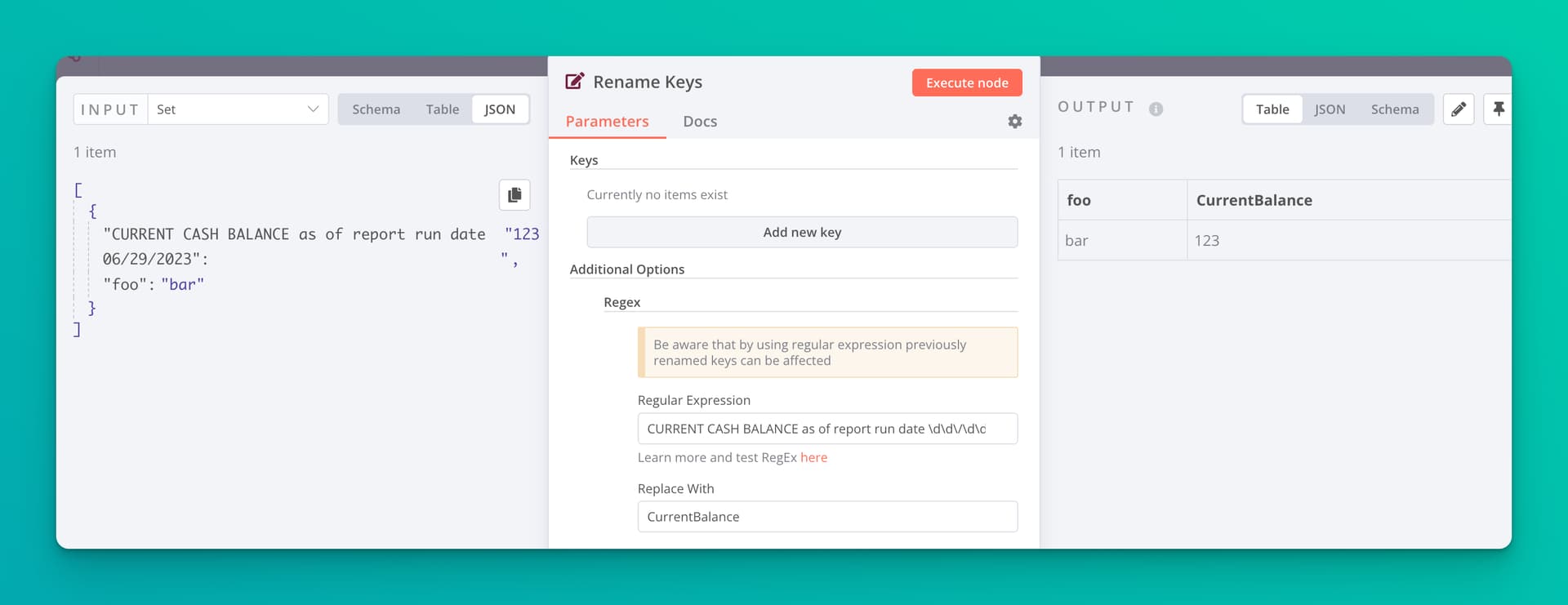

So originally I was thinking maybe a code node would be the option here, Do a loop over the keys and it it matches your pattern do a rename. I then remembered that we have a “Rename Keys” node which I have not used before.
Turns out it has an expression option in it so you can just pop in CURRENT CASH BALANCE as of report run date \d\d\/\d\d\/\d\d\d\d as your regex option and then a new value under it like CurrentBalance and problem solved.
Little workflow example below for you.
