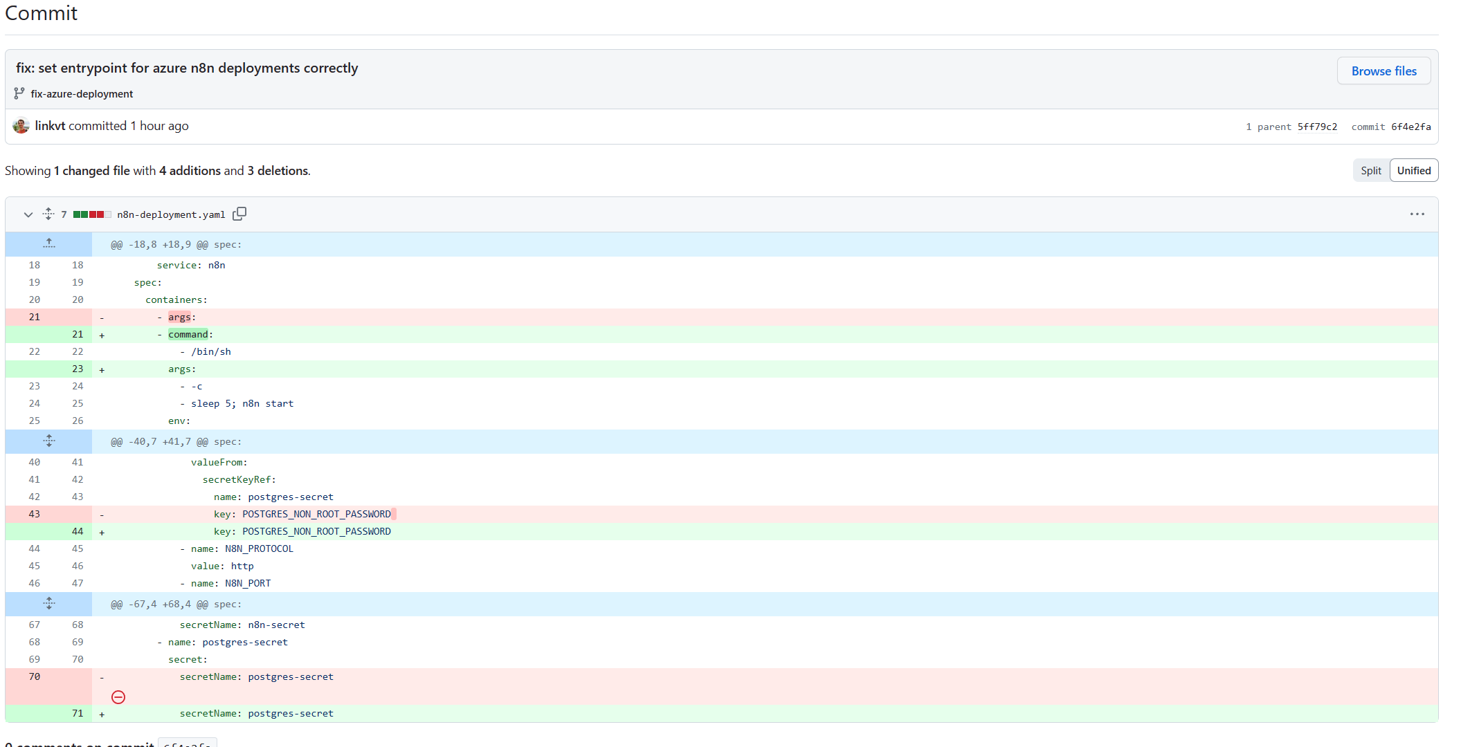

We did some more debugging. Looks like we had two errors.
  1. We had to patch one of the files, see screenshot below
  2. The password cannot be the same for both postgres users. We’re doing a test install and were just keeping it simple.
Seems to be working now!
Looks like a good spot, I wonder why the password can’t be the same :thinking: The permission change is something that shouldn’t be needed and will likely be fixed in an update soon but it is handy to have a temporary solution thanks.
