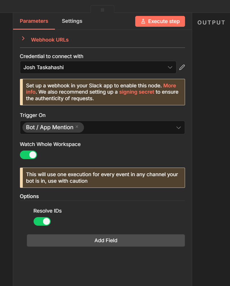

Hi guys, i have a small problem with my slack trigger. When i use ‘new message posted on channel’ it responds perfectly, but when i switch it to ‘bot/app mention’ it doesnt respond, it doesnt hear it. do you know what is the problem with that? All needed Oauth scopes are added

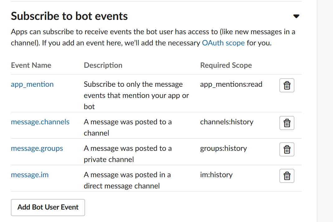

you actually have to tell Slack to push that specific event to you. Go back to your Slack App dashboard, click Event Subscriptions in the sidebar, and under “Subscribe to bot events,” explicitly add app_mention. Once you save that, make sure to hit Reinstall to Workspace at the top of the page—if you forget that reinstall step, the new event won’t activate. Also, double-check that your bot is actually invited to the channel (/invite @YourBot), and it should start responding immediately!

Thanks, I tried it now, and it still doesnt work. Is it problem because its supposed to watch whole workspace?

Tried it, still the same problem. The thing is that that agent will work on channels and on dm, so i added ‘im’ and when i send it message, it doesnt hear it, but it does respond once i switch it back to ‘new message posted on channel’. I even deleted it and installed it again and have the same problem

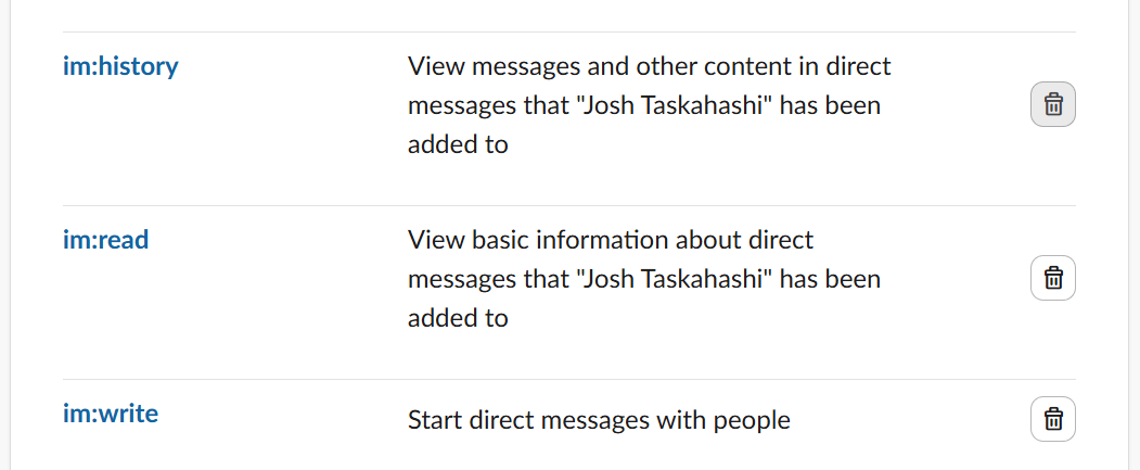

Hi @Boca_Samood Maybe this is a permission related issue have you tried giving all the permission the bot needs?

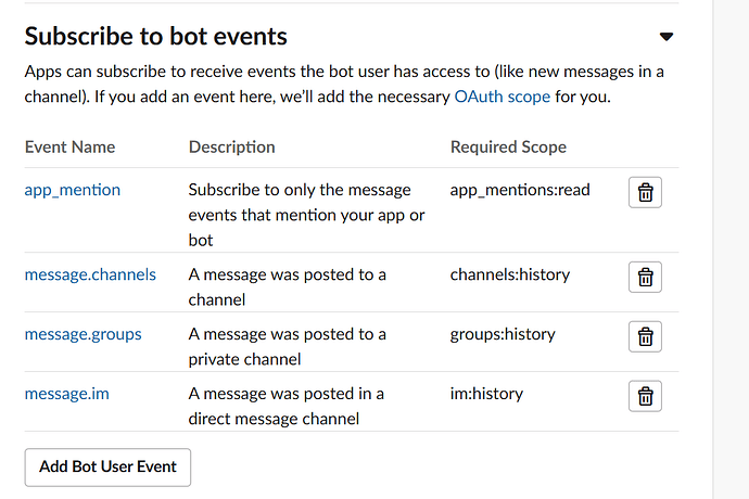

I’ve dealt with this before and i think there’s one permission you lack which is message:im,
once you do that it will start triggering your slack trigger.
I’m assuming you have done everything correctly apart from this, If you ned anymore help let me know as I’ve built a lot of slack apps and connected them in n8n before.
The above picture shows the correct setup, in the request URL paste the webhook url (Production) one and subscribe to those 2 bot events and you are good to go.

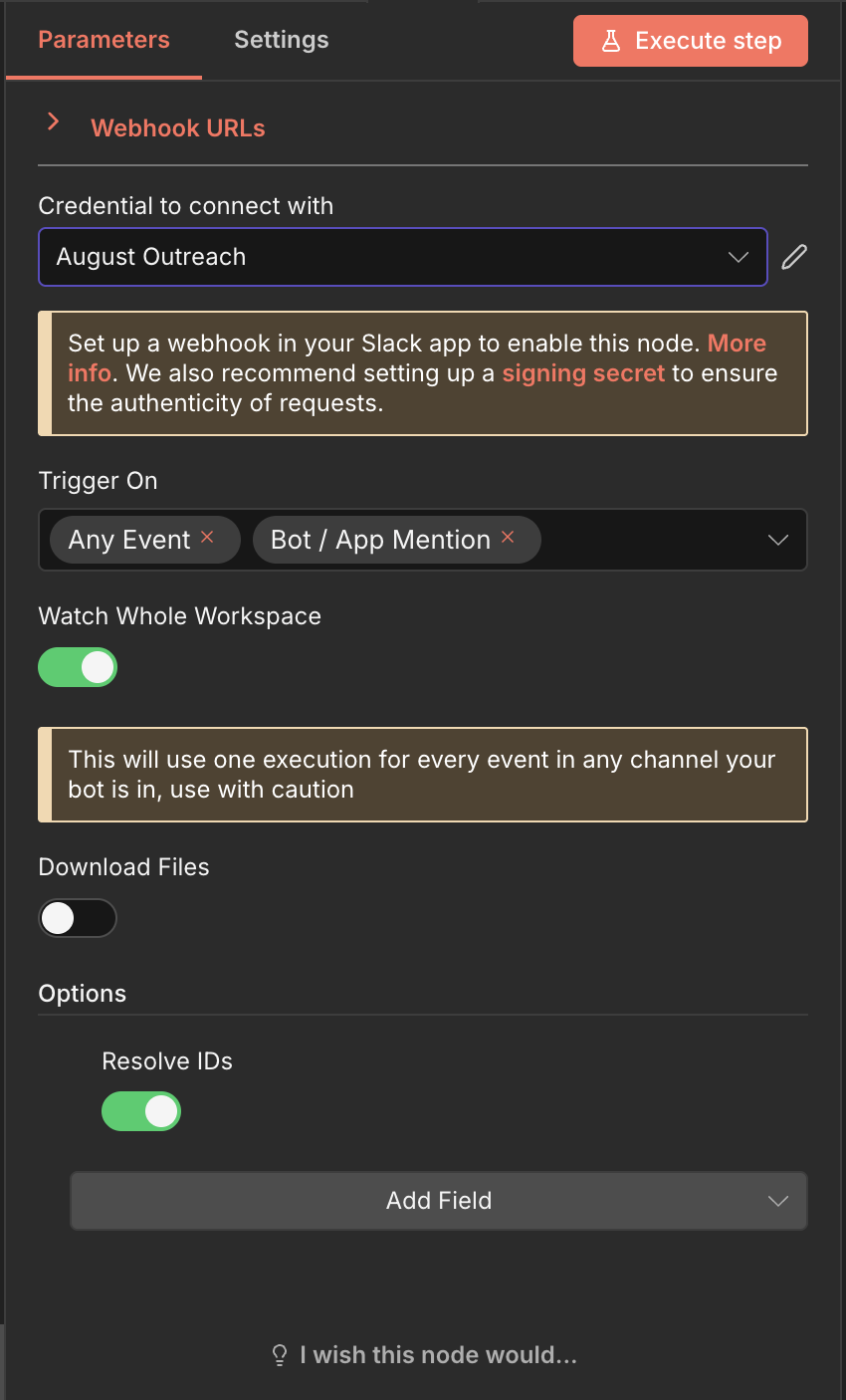

This should be your node configuration of the slack trigger.

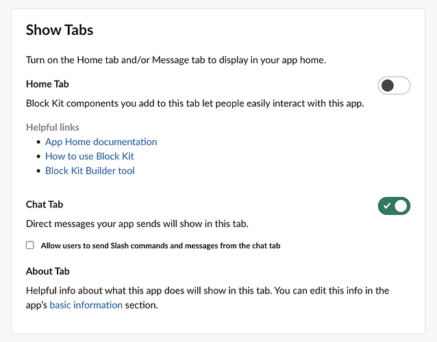

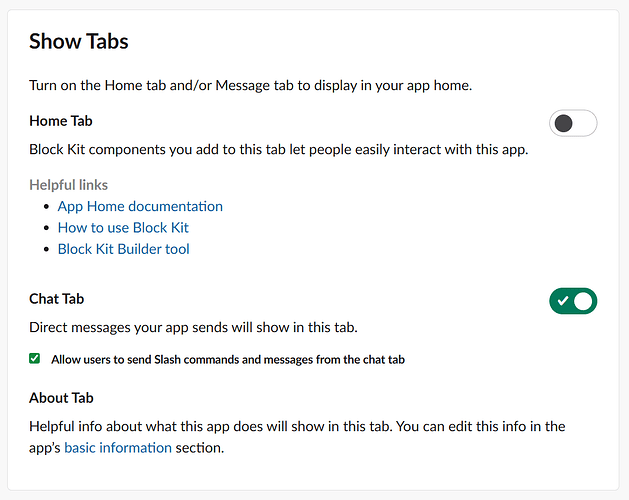

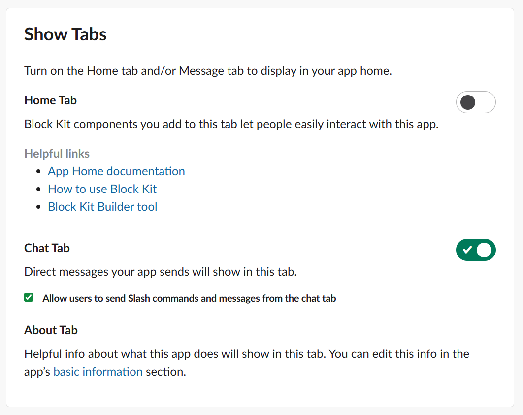

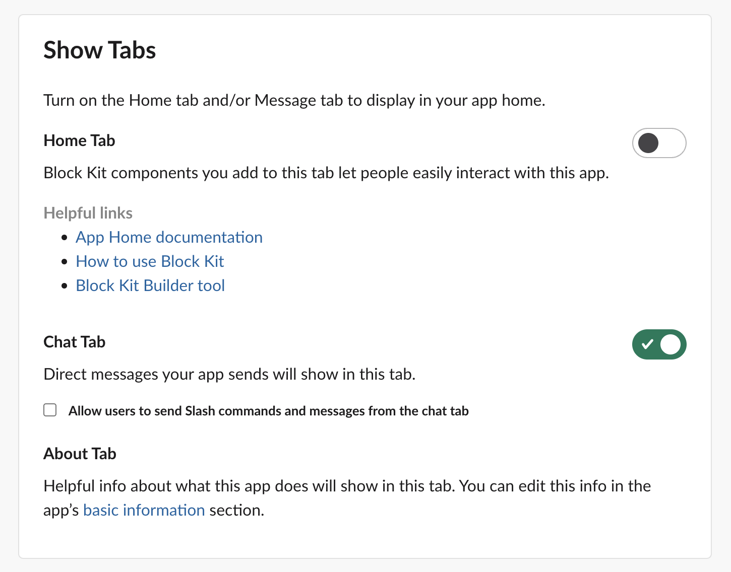

Hey @Boca_Samood Can you please also add any event in the trigger and also please navigate to “App home“ in the Slack API configuration page and please toggle on the “Chat Tab“ option, Then you’ll be able to chat to it in a separate window as you want it to be
yea, i did that, like i said it worked totaly fine when trigger was ‘new message posted on channel’, but the moment i switched to ‘bot/app mention’ it doesnt respond to dm’s

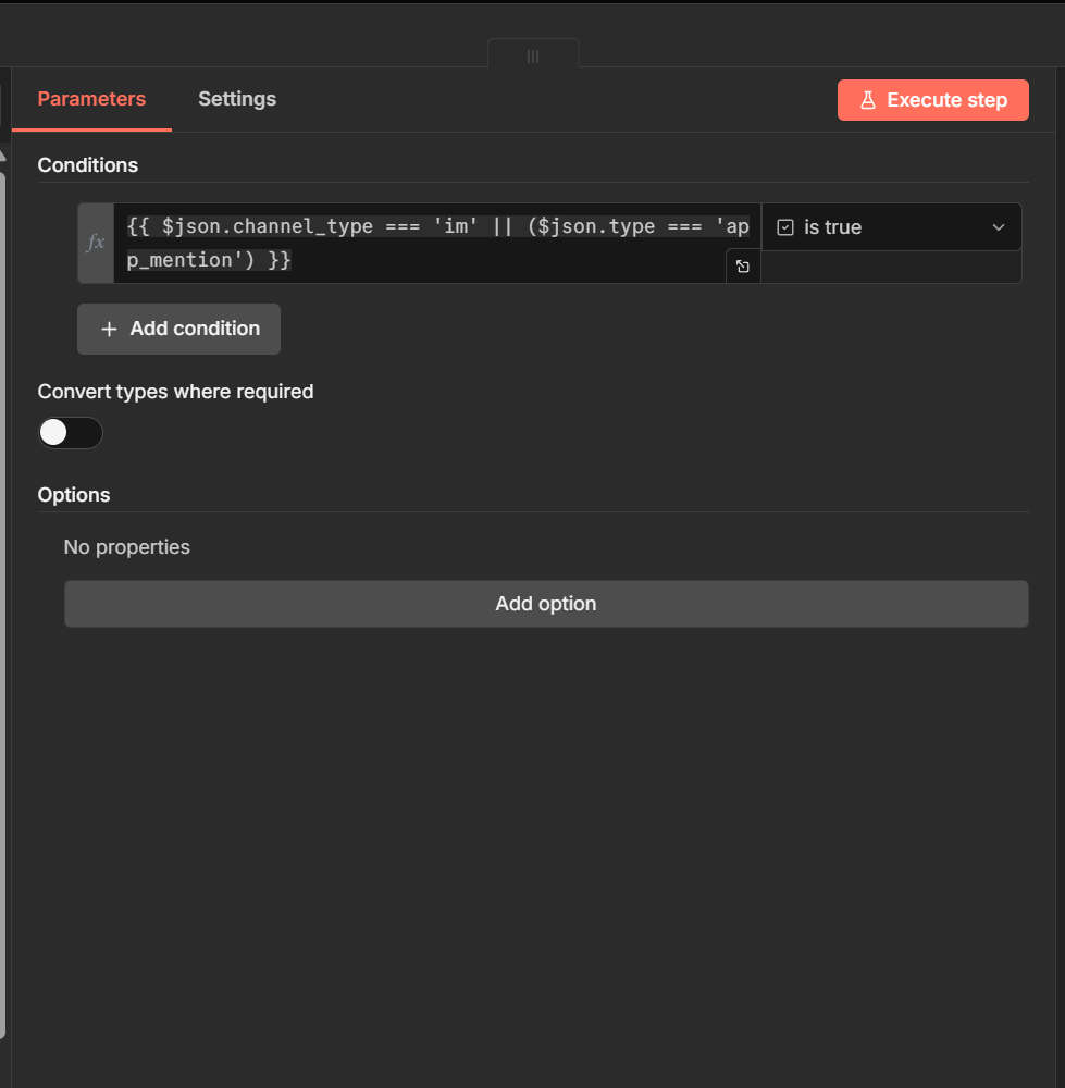

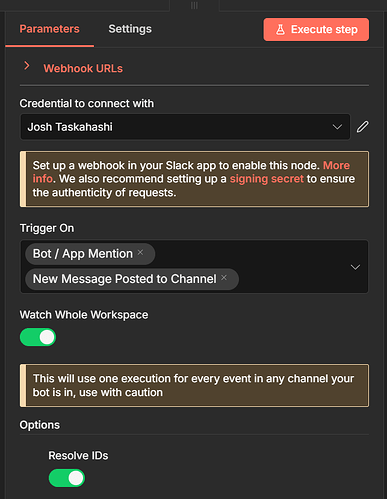

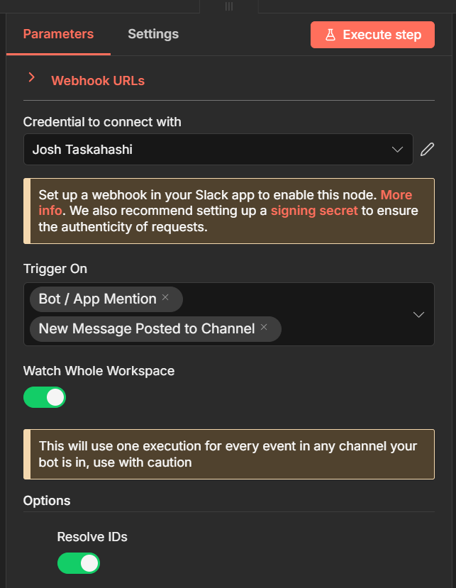

Hey guys, i fixed it, i added both options in trigger and in filter i added this
