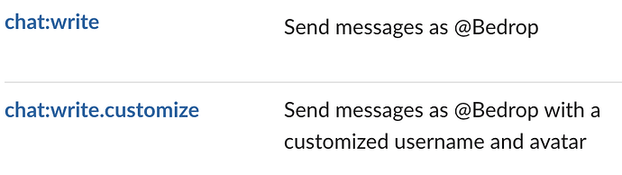

Yea it starts with xoxb-. In the Bot Token Scope I have also added these Scopes to enable it to act as the bot

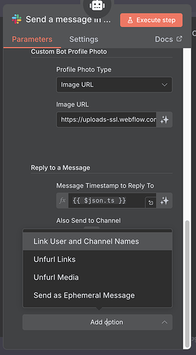

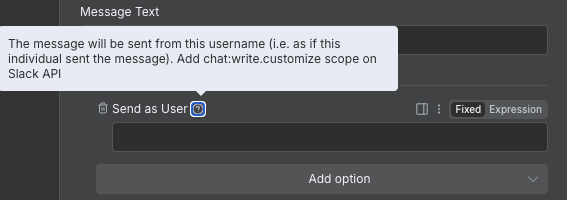

In the slack node, could you try adding this from the options at the bottom?
That option doesn’t exist in the Slack node. I’m using the Send Message to Slack node as an AI Agent tool.
