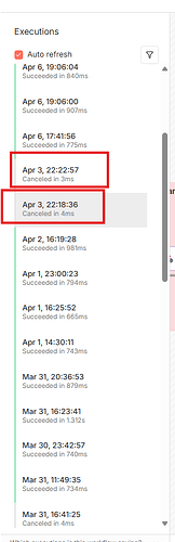

it’s working for months so I don’t think bot scopes can be the issue or buttons. We usually approve it within an hour or two so timeout is also not a factor, I just added it incase this automation run on weekend and if no one approve it then it auto progress and that was also working fine and we tested it.
You can see it’s working fine, just those two cases where it gave error. (Attached)

I would recommend updating your n8n instance to the latest stable version (2.15) and testing again. This behavior looks more related to how the Slack “Send and Wait for Response” is handled rather than an issue in your workflow configuration.
I’d also check whether the execution is being cancelled due to a timeout or an instance restart while waiting for the Slack callback. In these cases, executions can appear as “cancelled” and return no output.
This issue has been documented before and is caused by the sendAndWait node losing tits webhook resume link. Some of the causes of this can be:
-Retry on Fail is still enabled, this can sometimes cause multiple webhooks to get registered, this confuses the wait mechanism. You can try to disable the “retryOnFail” on the sendAndWait node which could help.
-Duplicate executions where your workflow is being triggered more than once for the same event. The second execution overwrites the Webhook ID so when you click the button there is nothing to resume.
-Your execution may have timed out. If your execution times hits 24 hours before someone responds, it will cancel silently. Check to see if responses are taking more than 24 hours to come in and if so, try increasing the limit.
