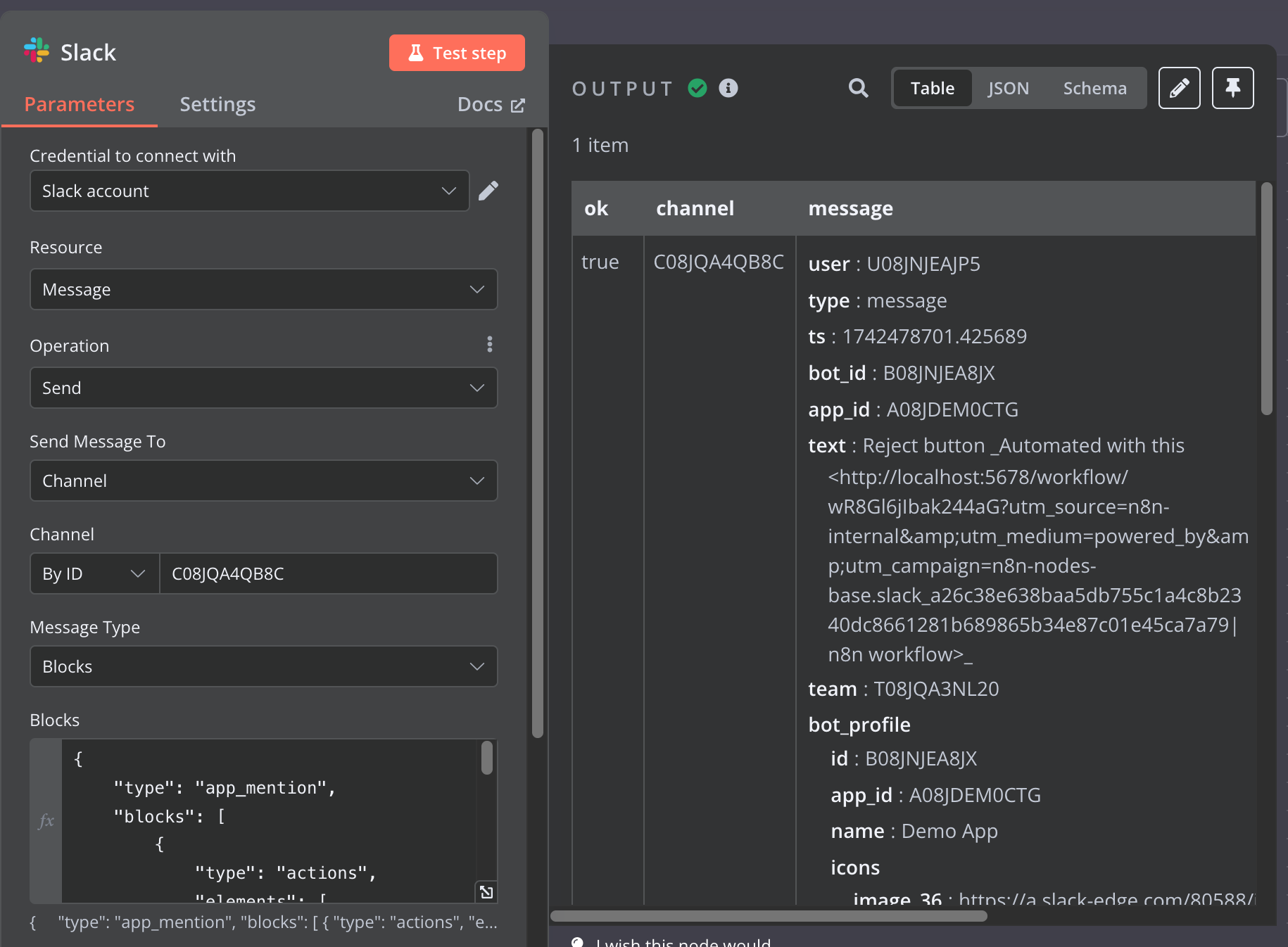

I suspect this may be either a configuration or permissions issue. I’ve gone ahead and copied your node and I’ve managed to get it to post to my Slack Sandbox successfully:
To be fair, my local instance is running n8n version 1.83.2, so I can attempt to rollback my installation and test it on 1.72.1 as well, but let’s confirm your Slack App’s permissions before we determine if it is a version issue, since I can’t see any related bugfixes for this particular issue in the changelog.
Let me know if you’re still encountering this issue and we can dig into the permissions and scopes of your app to see what’s going on. Any screenshots or error logs you can share would also be very helpful (just make sure to not include any sort of credential information in them, of course).
