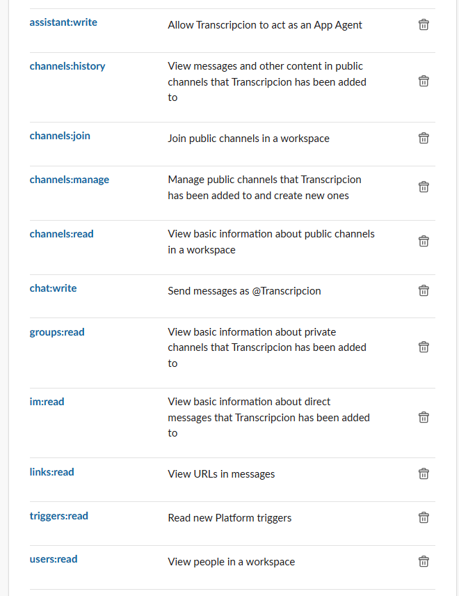

these are the bot token scopes:

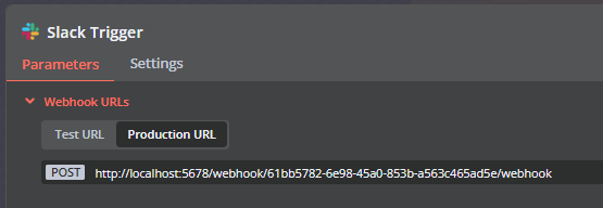

Open your trigger and check this URL:
Mayba that could be your redirect URL.
i did try that, it didn’t fix it. i tried both with the test URL and production URL

and these are the OAuth Scopes :
