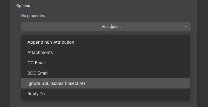

Is this because the cert is not trusted? Will adding the cert or its CA to the /opt/custom-certificates folder fix that? Or is there some configuration where I can disable this warning? I am using an internal corporate SMTP server.

If you know why you are getting this message and ok with it, ignoring the issue is an options.
Otherwise, adding the certificate is what I would try too.
Adding the CA fixed it.
