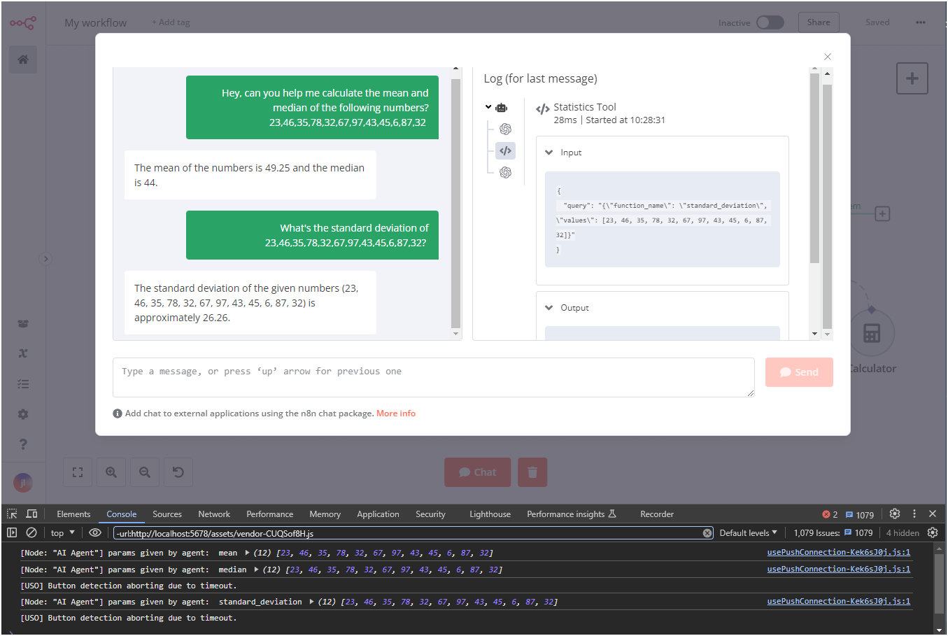

2. Agents don’t run the tools, they call them.
Think of tools calling like you would call an third party API. ie. AWS S3. When you want to put an object in S3, you don’t necessary care what internal processes are called or what datacenter was used. You just want know how to give the API the file and have it return that it was successful. This is the same with agents; knowing how you’re calculating standard deviation is not useful to them but knowing what parameters to pass in, is!
  • Define what API-like request parameters to pass to the tool.
    • :white_check_mark: Use Input schema to define request parameters (1.43+) else define in description.
    • :white_check_mark: Otherwise, define it in the tool description: { "function_name": { "type": "string" }, "values": { ... } }"
    • :x: "Call method sin() to perform sine operation", "if this ..., then do that ..."

Demo
