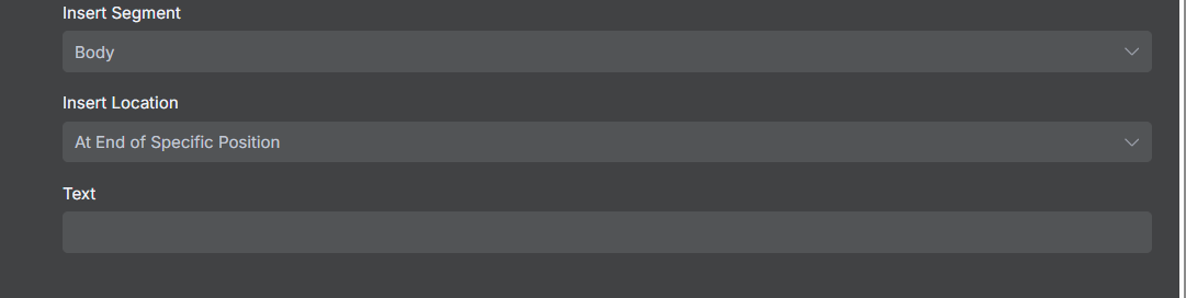

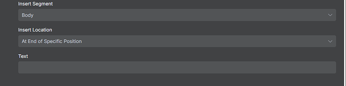

If I want to save the AI Agent output to the google docs, how can I do. Because now when I update a document, the docs will be blank, dont have the information
workflow you shared does not have doc id.
How will n8n know what doc you are updating?
using the create docs id
but you have not inserted id or url for doc:
when creating it must be returning id of doc, put it in doc id secction.
and:
output from ai agent in text
alright later I try modify it
