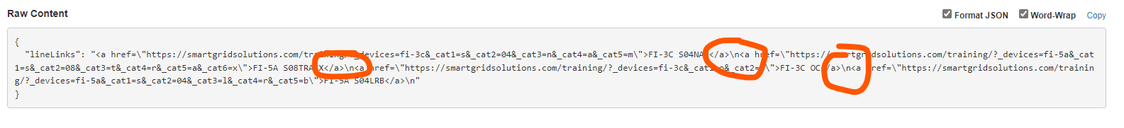

Hi @EricSGS, it looks like you’re using /n rather than \n in your JS code. Changing this would lead to n8n recognizing the line break, in the JSON preview you can see this indicated by spaces:
Sending this data to a service such as webhook.site you can see that n8n wouldn’t add additional escape characters:

Yeah, that’s it. Darn.
Thanks for the fix! Sorry about that! Works perfectly now!
