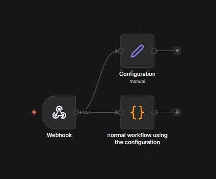

How about if the first node is a webhook, where I already receive data I don’t want to modify. How would you solve that? I was thinking about using a second branch, where I just do the config, then refer to it in my workflow. Is this the way to go or do you have any other ideas?
I was thinking about something like that:
Not sure if I understood correctly, but inserting variables into a data table is also an another method that might suit your case. Data tables live inside the n8n instance(built-in feature), so variables stored in there are safe as long as your instance has no security issues; you can reference variables from different workflows or branches in this case.
Data tables can accessed from https://your-instance-url/home/datatables.
