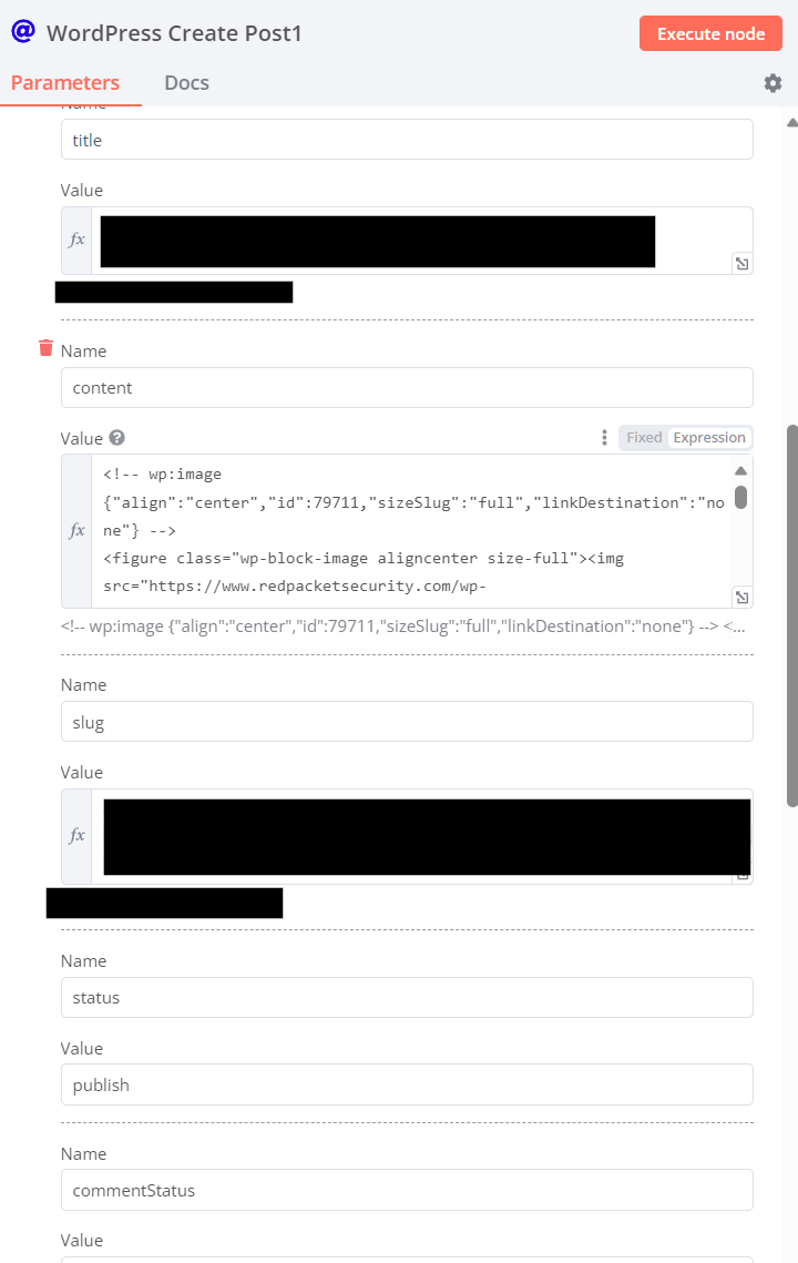

Let say i have several flows that do things, then they get to a point where they use a HTTP node
now in each of the flows, it does a similar action such as post to wordpress for example, but the tags and categories and content is different, except at the bottom of the content section, there is lets say a like and subscribe section in HMTL that stays the same across all of the flows.
So you have loads of custom HTML in the content part that is pulls across the flow
and then right at then bottom is my massive chunk of code with links, SVG, html etc that is the same in the flows, but at the bottom of this section of the HTTP node.
It’d be nice to instead of edit each one individually , just add
{{ Global WP-SIG }}
which would enter all of that
<!-- wp:group {"className":"support-box","layout":{"type":"constrained"}} -->
<div class="wp-block-group support-box"><!-- wp:paragraph {"align":"center"} -->
<p class="has-text-align-center">A considerable amount of time and effort goes into maintaining this website, creating backend automation and creating new features and --------------------------SNIP----------
</p>
<!-- /wp:paragraph -->
