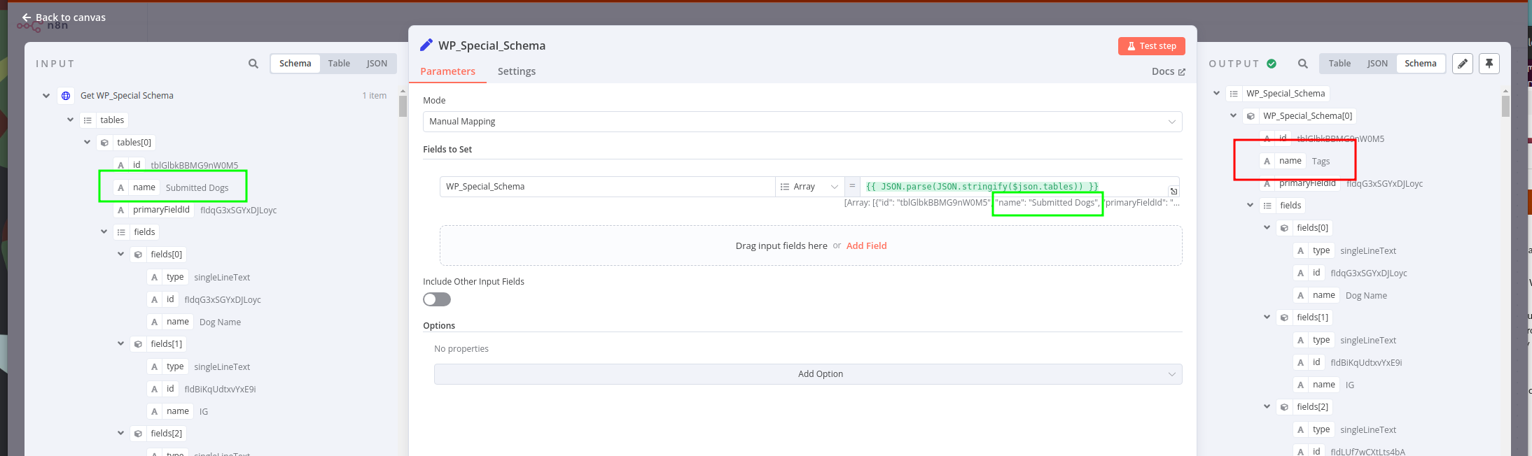

I’m using an edit node to rename an array named “tables” by using
JSON.parse(JSON.stringify($json.tables))
(I know, kind of overkill)
But VERY bizarrely, the value of one of the elements of the array is being changed. I cannot figure out how that could possibly be happening. See Screenshot:
The “name” value in the red box should match the name in the green boxes. Note that the table id above it is the same, just the “name” value has changed. I don’t get it.
I have restarted N8N twice, thinking maybe it’s some weird caching problem. No luck.

FYI, restarting N8N didn’t fix this, but rebooting the entire machine seems to have fixed it.

Sorry that you’re experiencing this issue — I haven’t been able to reproduce this issue so far but I’ll make sure to report this internally and will keep you posted!
You can write just {{ $json.tables }}. There is no need to create a copy of the array in the Edit Fields node
