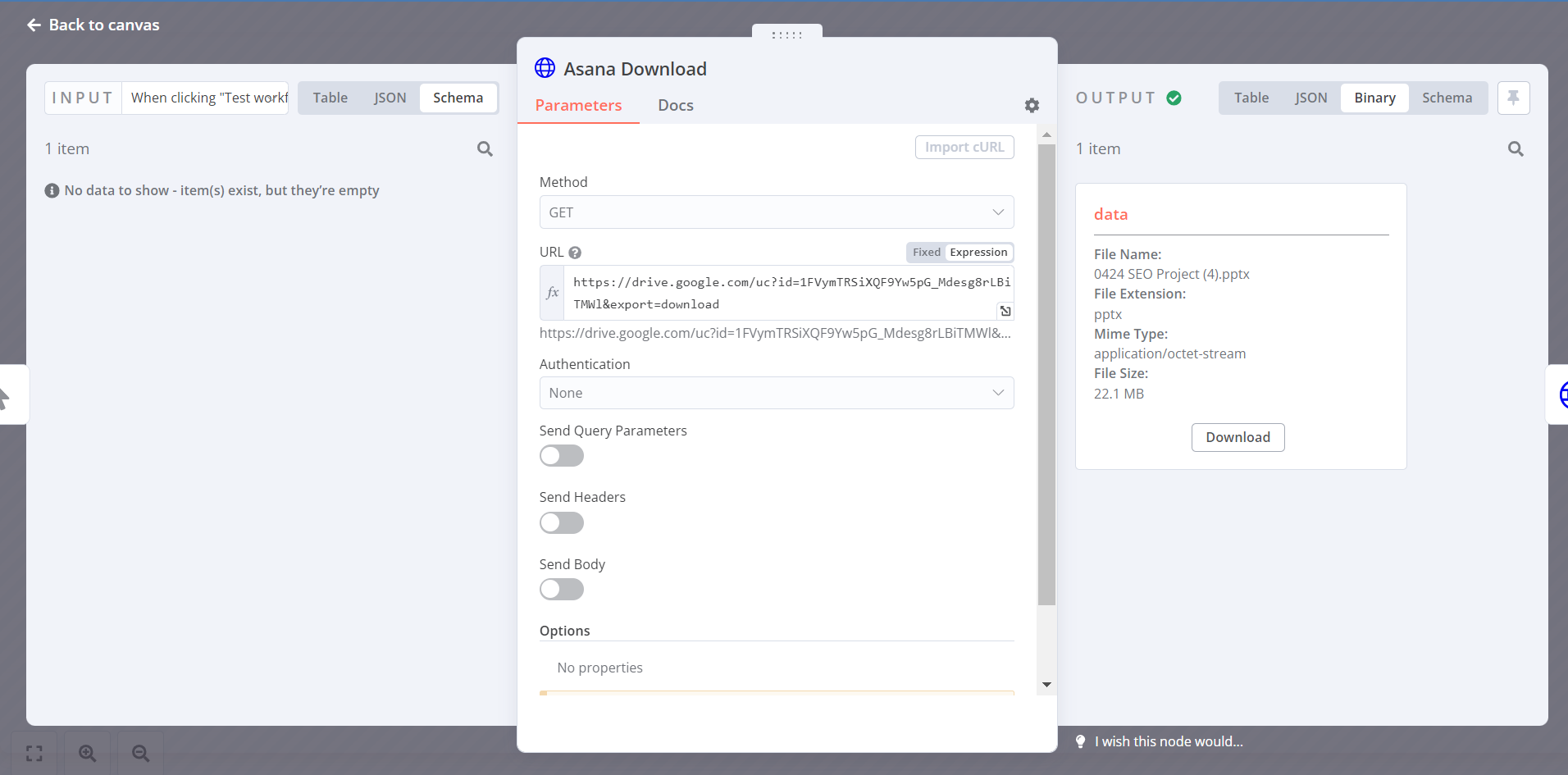

Here is the download step in the workflow (I get the AWS URL from Asana API)
Here is what happens when the file is accessed from a Googledrive link:

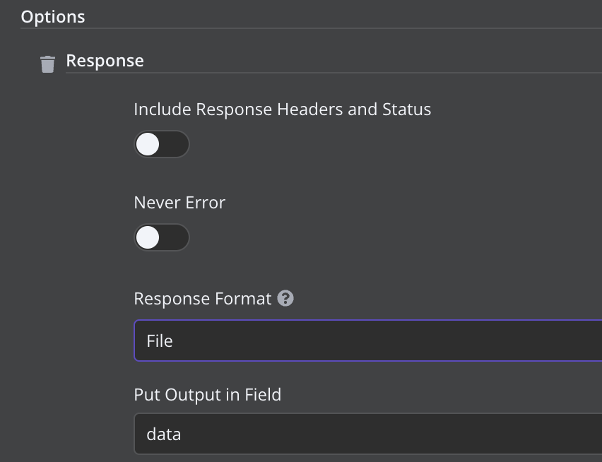

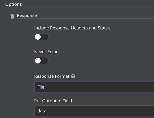

Try to set the File output option
Hey @barn4k it worked thanks to your help!
